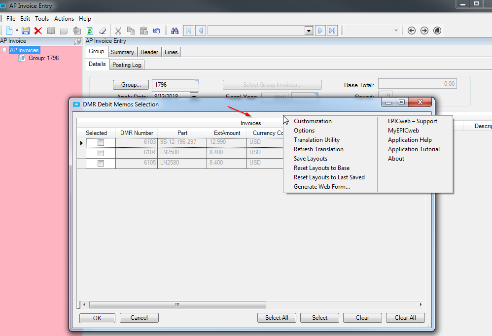

From AP Invoice Entry, when you go to Actions–>Get–>Get DMR Debit Memos, and then click “Manual Selection” . With that pop-up I do not see anyway to customized that or the gridview. Would like to add a few more fields to the gridview. Anyone have any ideas?
You need to be in Developer Mode when you open AP Invoice Entry. Once you have the manual selection window open, right click in the header area just above where it says “Invoices” and you should see the option for Customization.
