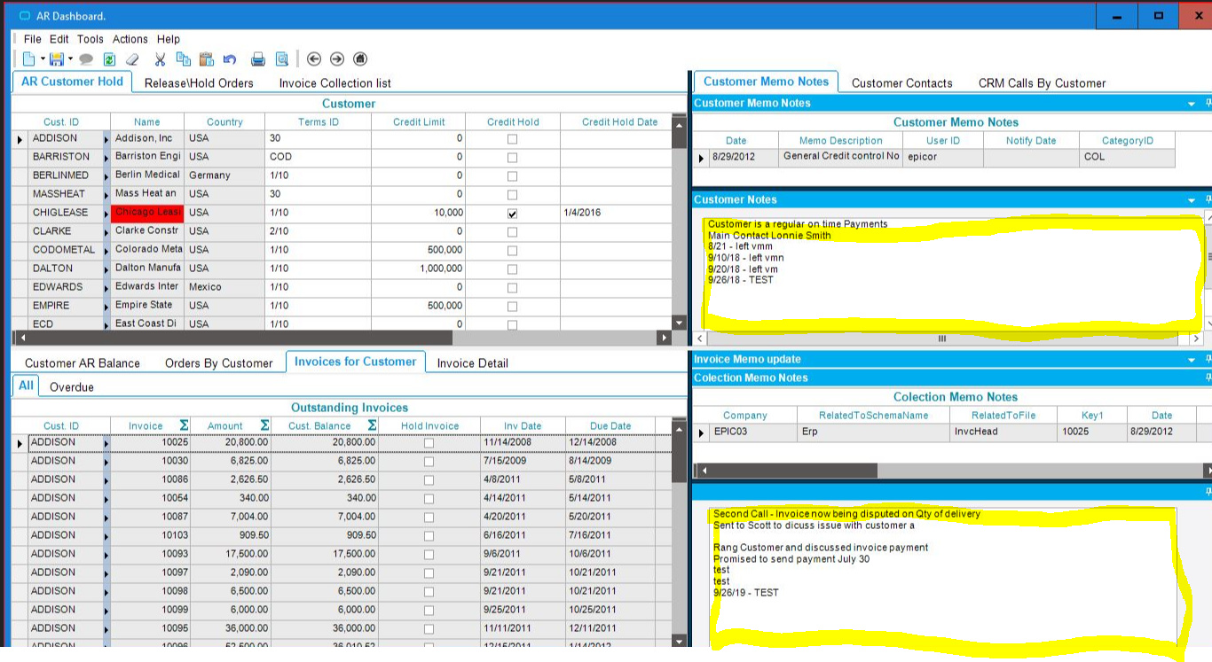

We were given this screenshot as an example of an “AR Collections” Dashboard. I’ve been able to recreate all of it except the highlighted boxes. Those boxes are displaying note fields, but my issue is getting the large free-form text box.
It doesn’t seem that Grid, Chart, Tracker, or Gauge will give me a box like this. How are free-form text boxes like this created on a dashboard?

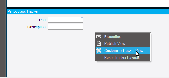

Put a tracker on the screen with the field you want, then customize the tracker view.
Make your box bigger by click and drag, and make sure the word wrap is set to true.
I think that should be it. Let me know if that doesn’t get what you need.
