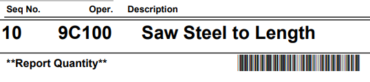

I just set this up to scan in Job, Assembly and Operation into the MES report qty screen.
I had to get the tab sequences right on the screen.
Program the scanners for the right Code 39 settings (using SSRS for jobs, wasn’t going to wrestle with QR codes outside of bartender)
Concat the fields together with Tabs in a barcode int the SSRS file using this:
="*" & Fields!JobNum.Value & "$I" & Fields!AssemblySeq.Value & "$I" & Fields!OprSeq.Value & "$I" & "*"

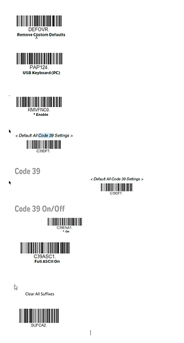

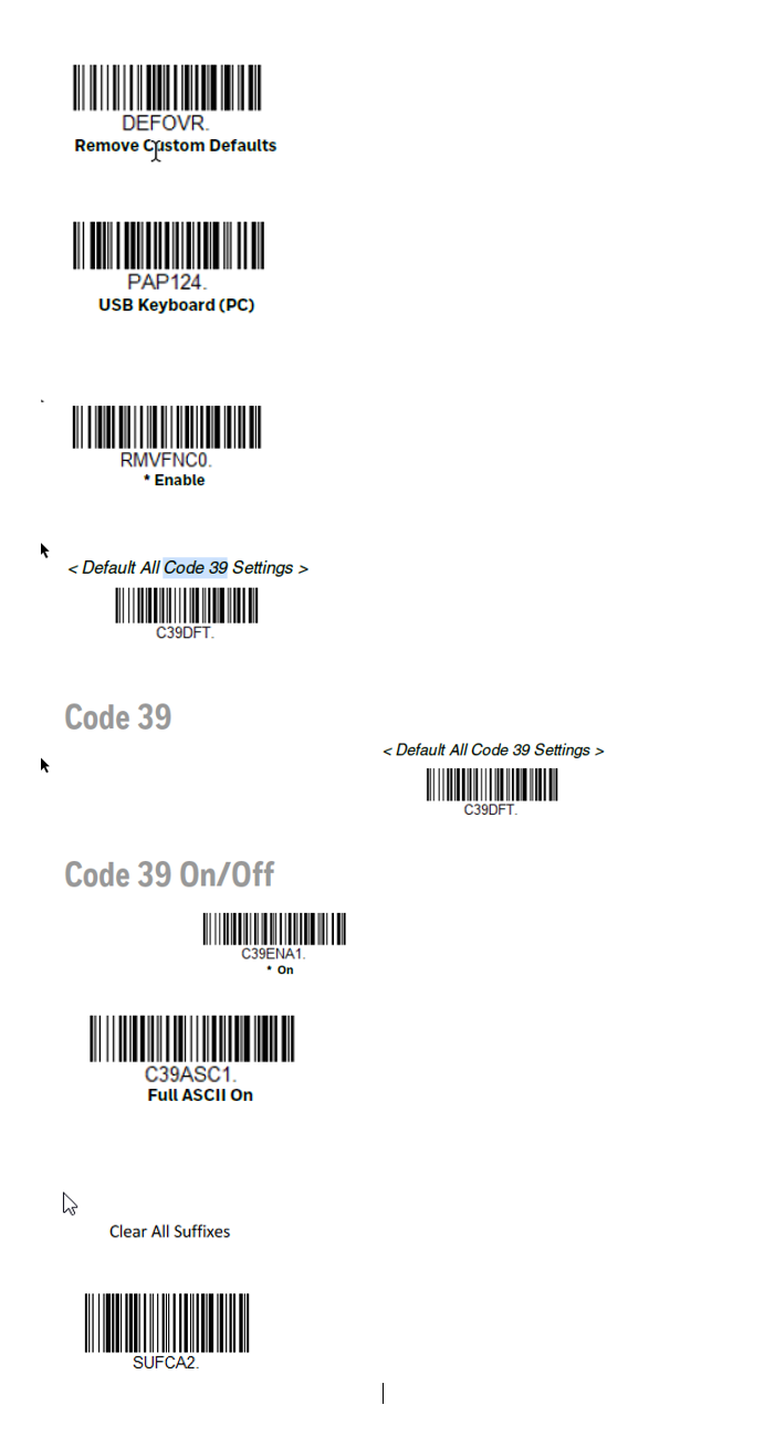

We used Honeywell 1470G with windows Mes terminals. I used the following barcodes to program scanners:
Thanks Bryan! Scanner currently being trialled is a Newland HR22-BT. I’ve concat the fields as you mention, I’ve tried the “$I” and get a @$I@ when scanned so it looks like the Newland isn’t set for Code39 ASCII? Have a Symbol reader here, will test and share findings shortly.
Finding the rights codes took some effort, hopefully that points you in the right direction. Full ascii was what I really needed.
