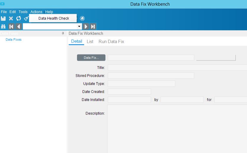

Hello, Epicor has sent a file to fix a problem we are currently facing with currencies. The have directed us to use the Data Fix Workbench but under Actions, I don’t have ‘Import Data Fix’ Option. We have Version: 10.2.600.23.
The scripts are imported on the server in the admin console and then run on the client.
Thank you
Also - The newer Epicor versions have the Actions > Import Datafix in Data Fix Workbench - we do in 2022.2…
