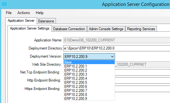

  1. Launch your Epicor Administration Console (EAC).
  2. Expand Server Management > name of your server
  3. Right-click on your appserver name and select Application Server Configuration.
  4. Deployment version field. What value is there?
If it isn’t 10.2.200.8, select 10.2.200.8 then click the Deploy button on the bottom right. This will upgrade the appserver to 10.2.200.8. After this, you’ll need to log into the client with a security manager user to complete the Conversion Workbench conversions.
