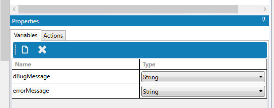

Create TWO new variables: dBugMessage and errorMessage:

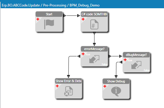

Now I add logic widgets to check if there is an error message and/or debugmessage… if there is, then I display them with widgets. Note that to turn off the debug logic, you simply need to disconnect the second condition widget so that it doesn’t run… OR you can also add a condition that it only shows for certain users or security groups.
Here is a complete display of the logic
