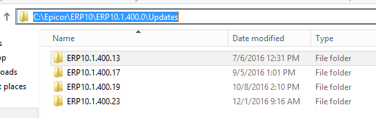

While doing some house keeping on the E10 App Server, I found some folders of updates for prior versions in C:\Epicor\ERP10\ERP10.1.400.0\Updates
Since all apps and DB’s have been updated to 10.1.400.23, do I still need the folders for .13, .17, and .19? (Combined they take up over 3GB)
Feel free to remove those folders if you will never use those specific point updates again.
