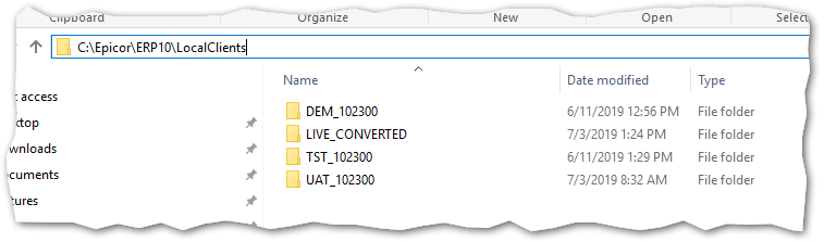

I noticed that on the App Server for my 10.2.300 installation, there are distinct folders for each App:
But on the workstation I’m installing the client on, there is just a single folder for the client files, and the various sysconfig files (for the various Apps) are all in the “…Client\Config” folder:
Won’t there be issues if the various apps aren’t using the same revision DB?
During the client install, should I change the destination folder to include the App name, like the App server has for its local client files?
