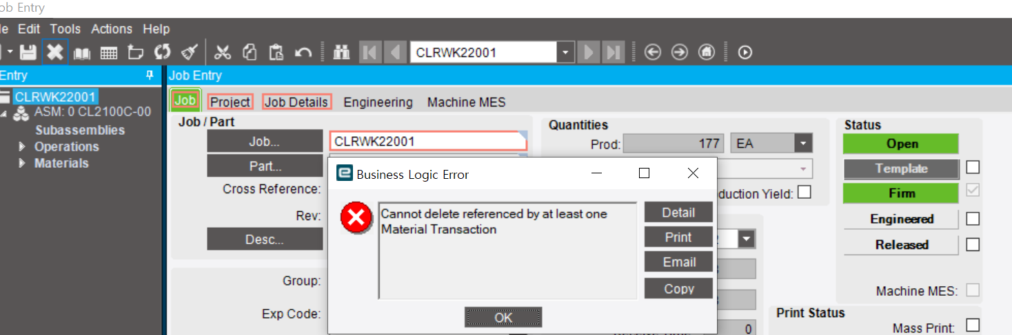

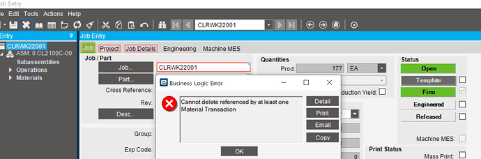

I need to delete the Completed Job. because it was not actually produced.
But the following message pops up. I think it’s probably related to Serial.
In this case, how do I delete this job?
You can’t do this… use job adjustment to adjust everything to zero and close the job.
Once a job has any material or labor transactions, it cannot be deleted.

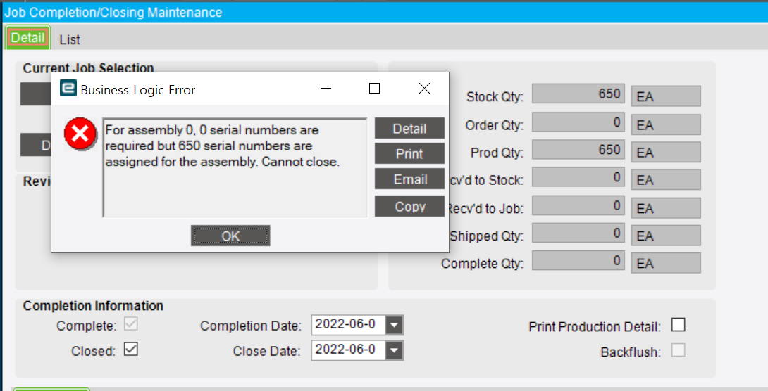

This message appears in Job Closing, how should I handle this message?

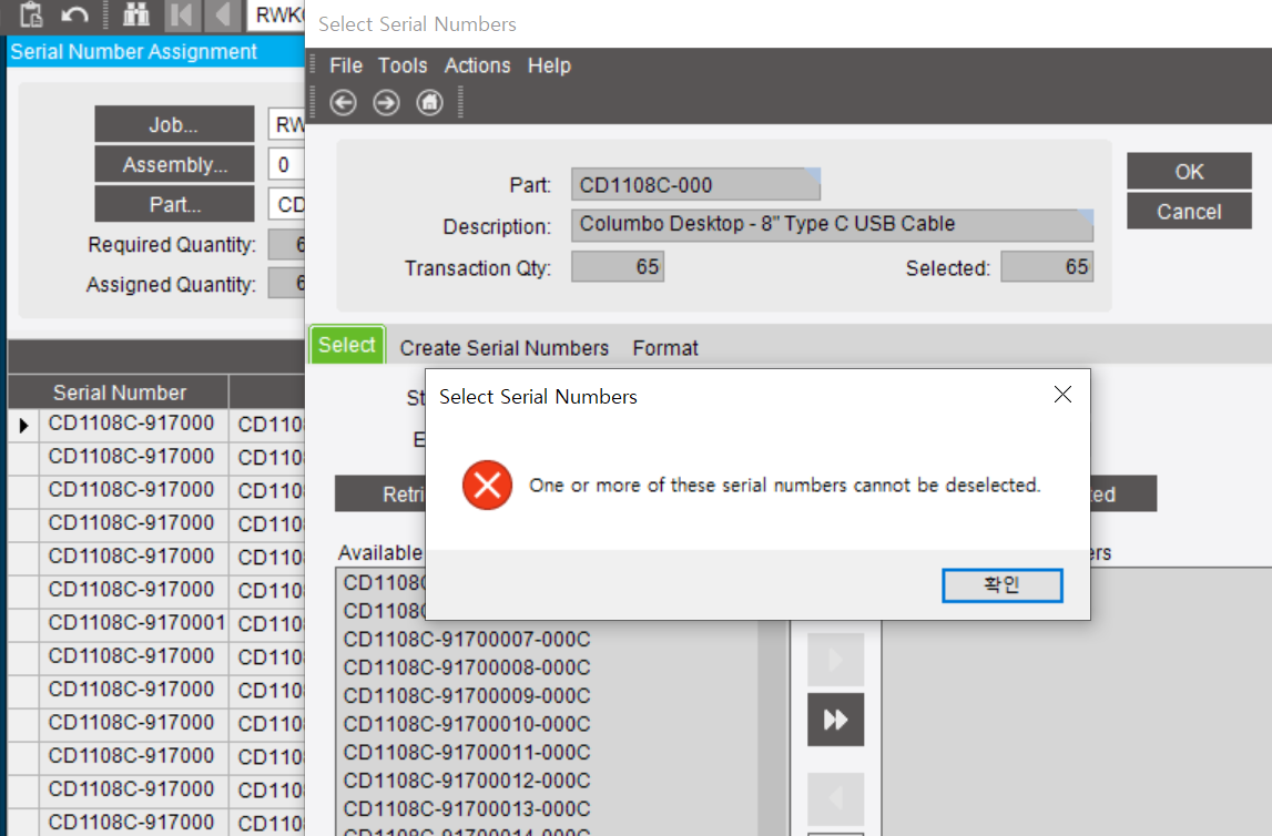

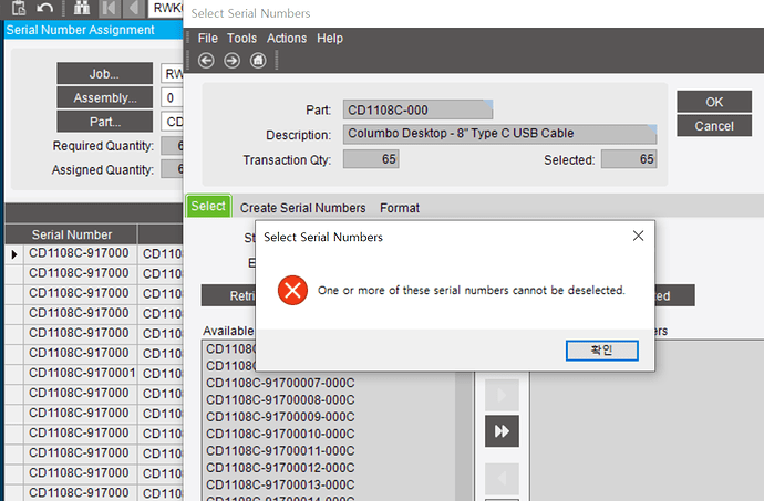

I tried to remove the assigned Serial in Serial Number Assignment, but the message below is displayed and it is not removed.
First, exit out of Job Closing. Go into the Serial Number Assignment program, enter your Job Number, click on the Serial Number button, then move all the serial numbers out of the “Selected Serial Numbers” box on the right to the “Available Serial Numbers” box on the left. Click OK. Exit out of Serial Number Assignment. Go back into Job Closing and see if you can then close the job.
NOTE: This may inactivate these serial numbers so that they can not be reused… try this first in a TEST environment!

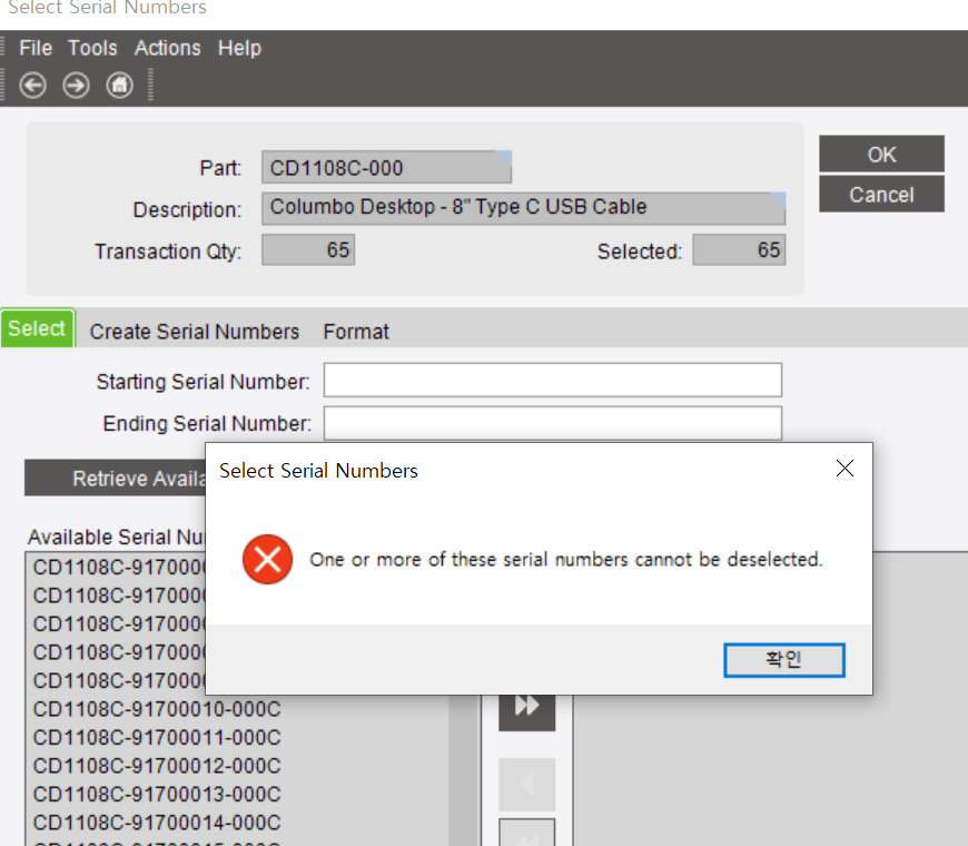

I tried to do that too. However, when I try to move all serial numbers from the “Selected Serial Numbers” box on the right to the “Available Serial Numbers” box on the left, I get the following message and the move fails.

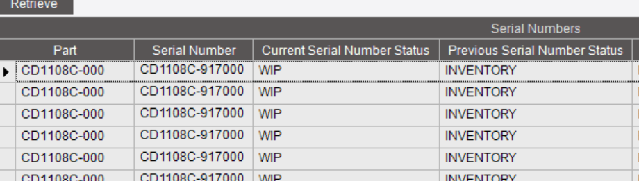

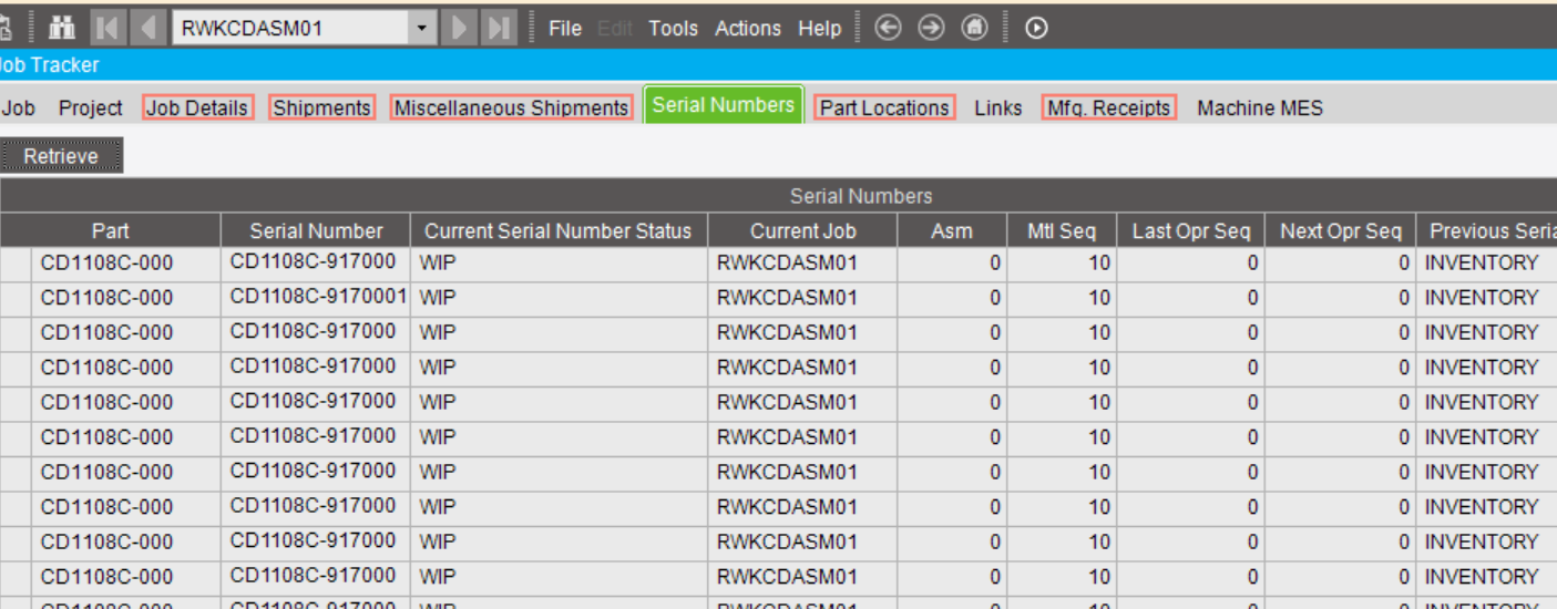

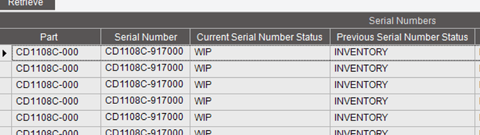

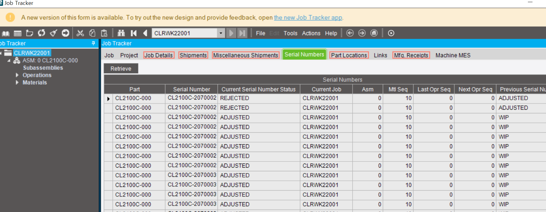

Go into the Serial Number Tracker. What is the Status of these serial numbers?
The grid shows that the Previous Status was Inventory, and the Current Status is WIP… which makes it look like they have already been received to stock and then returned back onto the job… meaning that a transaction has already occurred and therefore this serial number cannot be deleted or removed.

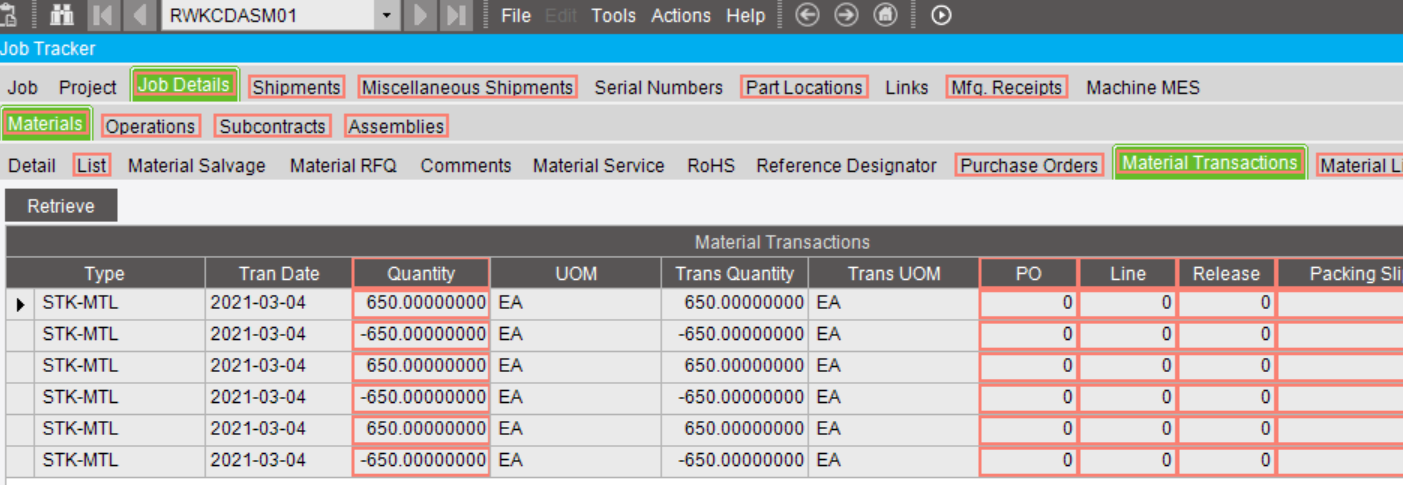

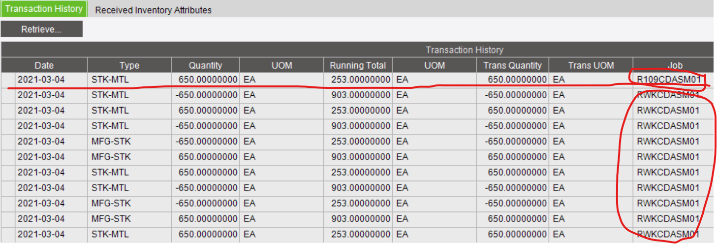

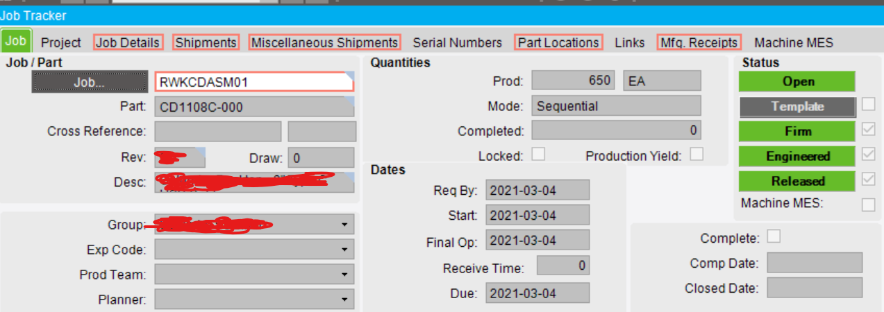

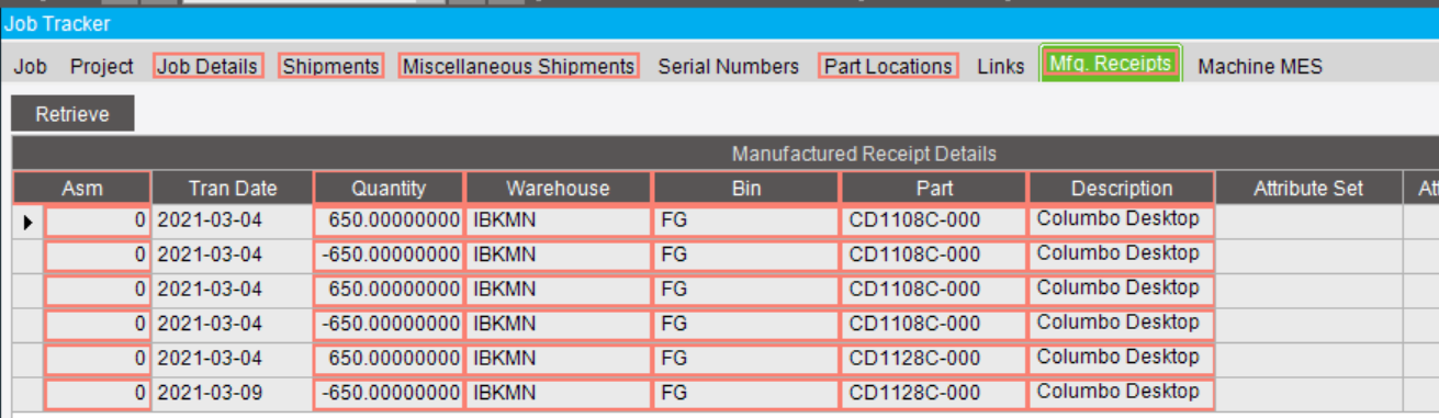

This is a rework job. As you can see in the transaction history below, we started a job with this Job (RWKCDASM01), but this Job ((RWKCDASM01) needs to be destroyed because someone else finished it with another Job (R109CDASM01).
But, since the Serial is already assigned, it cannot be deleted or closed.

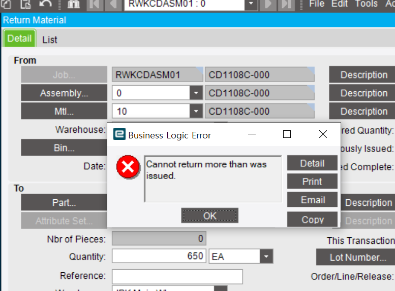

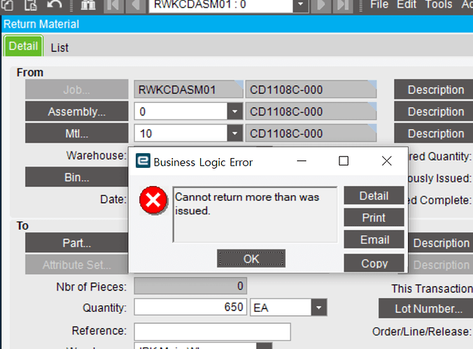

Can you un-issue (Return Material) the serialized parts to Inventory? Right now they are “trapped” in WIP, so your first priority should be to clean out the job as much as you can.
