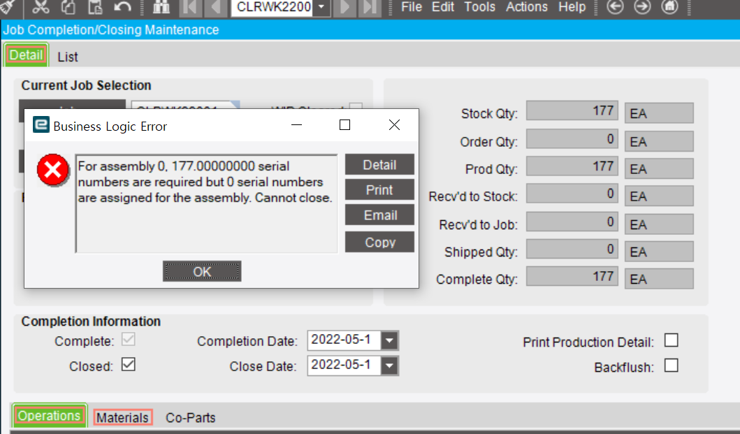

Hi everyone,
When I try to close the job, the following popup appears.
Can you please help me what the problem is?
Thank you in advance.
There is a serial tracked part somewhere. Does that say 177 are required? Looks like a material in your top level assembly
Change the completed qty on the last op to zero or assign the 177 SN’s to the job.
I’m guessing the job produces a serialized part, but that “Serial number required” isn’t checked on any of the ops, so users aren’t prompted to assign the SN until they move from WIP to inventory.
