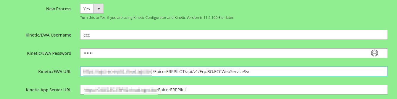

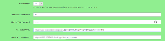

We are trying to do the same. We were advised we needed the latest version of ECC and Kinetic, which we now have. It looks like we need to pass a URL to a Kinetic REST Call in the configurator configuration on ECC but have no clue what this is.
We have taken a guess but this did not work.
I have an open ticket with EPICOR support, but they seem to be struggling. has anyone managed to get this set up and working yet?
If you’re using the new process then the URL needs to be
https://[SERVER]/[APPPOOL]/api/v1/Erp.BO.ConfigurationRuntimeSvc/GetECCConfigurator
From what I understand there is no need to deploy EWA anymore, the Kinetic layer handles this.
