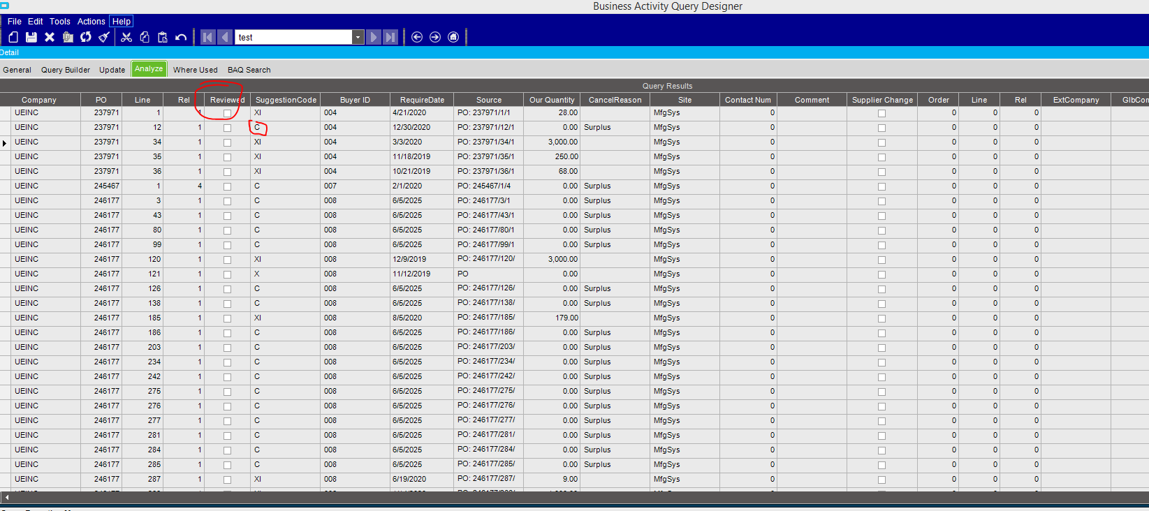

No but it would at least tell you that someone ‘Reveiwed’ the suggestion. A quick query of table SugPOChg would reveal whether or not your releases were considered in the workbench. Look for a checkbox on the Reviewed box and especially look for a C for cancel suggestion.
