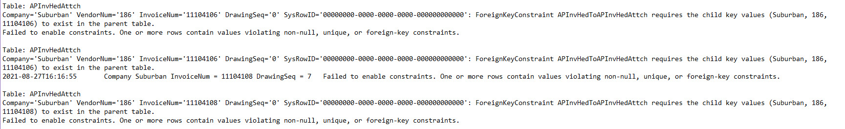

I am running into a strange issue trying to use the DMT tool (GUI) to upload file link attachments to the AP Invoice Headers. When I have multiple AP Invoices for the same supplier, DMT will upload for every other record (i.e. 1st, 3rd, 5th, 7th record will upload correctly, 2nd, 4th, 6th, 8th record will fail) with an error message similar to the following (attached pic).
DMT kindly spits out an Errors.Reprocess.csv when it encounters any error during the processing. Running this file without changing anything will produce the same behavior where the 1st, 3rd will upload correctly, 2nd, 4th etc. will fail again. I can run each iteration of the Errors.Reprocess.csv file without any further modification until the final failed record, and all will eventually process.

This sounds very familiar… I think it is either a true bug, or might have something to do with the DrawDesc field. Can you post a sample of your import file?
Hi Tom-
I finally got support to admit that this is a indeed a bug and is documented as problem PRB0238909.
