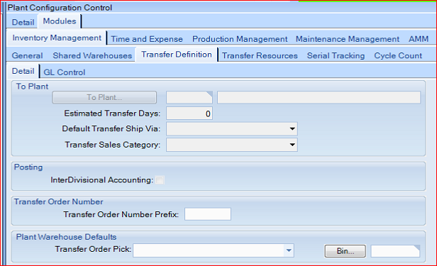

In Plant configuration Control there is a Transfer Definition Tab
Agh, I didn’t realize I needed to set that for DMT’s. Thanks I thought it was for Transfer Orders only.
