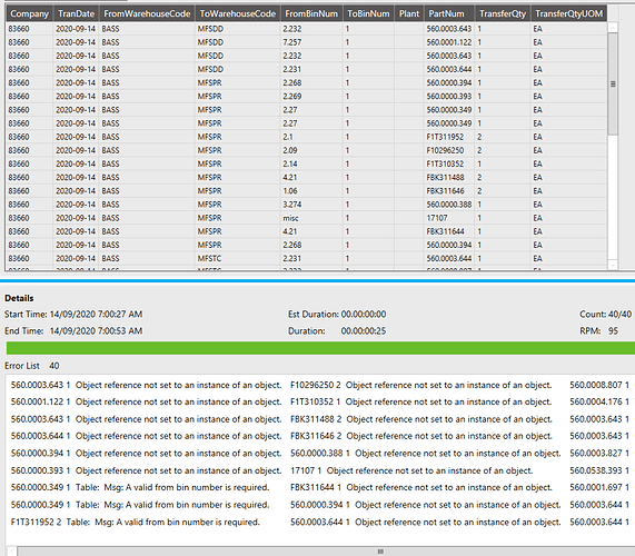

I have been using DMT Inven Tranfer for a while. Using the same template. and now all of a sudden i get the above error on every line. Has something changed in Epicor? Does anyone know what would cause this error?
There’s no Value in the plant column
I know. It has always worked without it, and i also entered it in and i still got the same error message.
What about the future date (tomorrow). Is that typical?
Also, is this set to add, update, or both. It might need to be set to both.
Changing the date back a day does not help. And i have just noticed the Add New box is ticked, But the Update box is greyed out. Maybe i have lost some authorization in the back ground that is stopping me?
Inventory transfers create new parttran records. You can’t update parttran records.
Bins are strings, and it looks like your bin numbers with a ‘.’ in them might have been converted to decimal first.
For example, you have a bin2.269 and one 2.27. Should that second one be 2.270?
Edit
If your making the file with Excel, make sure to set the Bin columns to type Text.

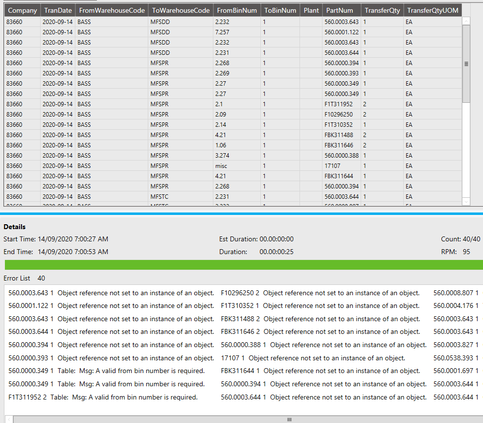

Hi,
I have just rechecked the bins and it still has the same error. We do have some bins as 1.00 and some as 1.000… etc. but the bin numbers are correct.
It might be due to DMT version update. Please check it.
This might sound daft, but how do i check that?
I have tested in DMT version 10.2.600.10 and got same error message. It looks like a bug in DMT (its failing in ChangeToBin method). Please log a call with Epicor.

I am running into this on 10.2.600.10, did anyone find a solution sans upgrading the entire application to a higher version?
Ended up needing to change the column order in 10.2.600.10 from 10.2.600.5, fricken thing
New column order:
Company
Plant
TranDate
PartNum
TransferQty
FromWarehouseCode
FromBinNum
ToWarehouseCode
ToBinNum
TransferQtyUOM
FromLotNumber
ToLotNumber
