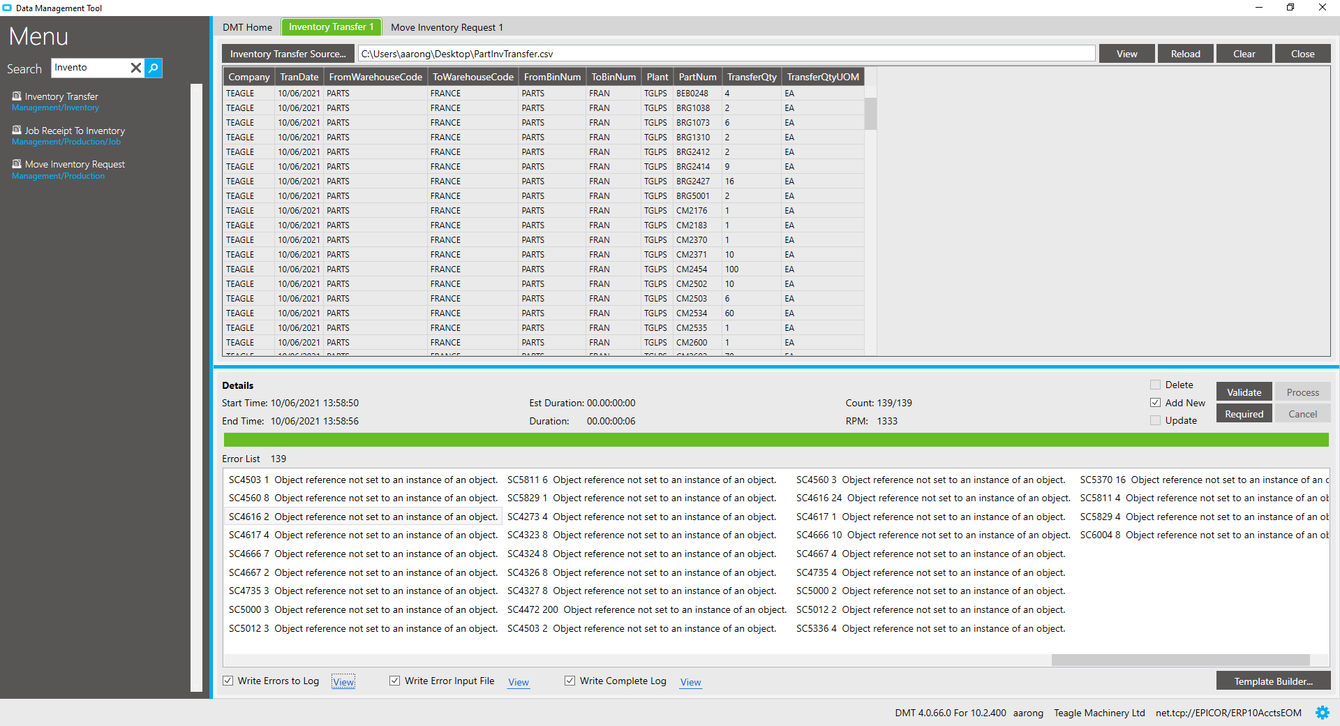

I’m getting this error when transferring from one bin to another in the same plant… Any ideas?
Object reference not set to an instance of an object.
It’s coming from TGLPS Plant with from PARTS to FRAN which has the which is one the same plant but different bins…
Any ideas? Error doesn’t tell me much.

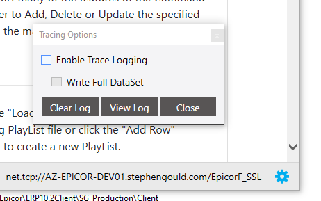

Did you try a trace?
Just in-case if anyone is following on this post and require solution:
The columns should be in correct sequence like this:
