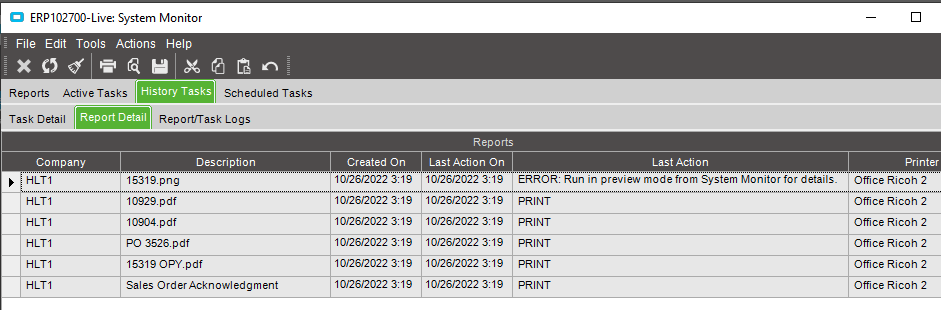

We are using DocStar and have a custom routing set up so that when we print the Sales Order Ack, it also prints all of the DocStar attachments. It works great for PDFs, but when we try the same and there is a .PNG attachment amongst the PDF attachments, we get this:

Are .PNG files just not supported? I tried locating a list of supported file types but have been unable to locate a list. Any ideas to make this work?
I don’t believe they are an acceptable doc type. There is no default ‘printing’ app for PNG files, not in a traditional sense even though Windows does open it in an app. I believe that it has to be one of the common doc types that convert to PDF.

To explore this a little further - because my coffee just kicked in - It has to make the calls to retrieve the documents via the appropriate storage options (eg. one may be in Docstar, one in SP, one in the file system). So we know it’s using some of that Doc Mgmt setup data. But how would it know how to create, or if it even could, a PDF from the file? There is no limit to the file type you can store, given that you have some useful way of viewing the document later (Doc Association). But the APR code would have to know/use the equivalent ‘Print to PDF’ command for every one of them - or be able to ‘Print to XXX’ them into something a Convert-To-PDF library could work with. The Doc Association commands are for viewing and printing, but interactively, not invisibly - because there is no spec for ‘output’ documents on the print command. Currently I think the library I mentioned is being used for each attachment, and when the standard ‘convert this to PDF’ command is issued, the PNG file is choking it.
