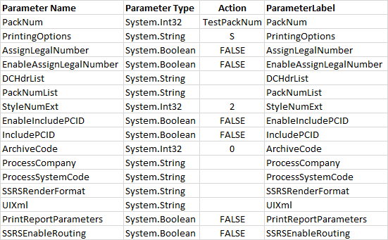

What are each of these parameters in the “Report Parameters” tab of the “Setup Auto Print” dialog of an Auto Print block in a BPM? (the report selected was the PackSlip)
PackNum is the only one I changed from the default. It was “The 0 Constant”. Changed it to “The specified expression”, with the expression just returning the BPM variable TestPackNum (which is set in a Exec Cust Code block). I did change SSRSEnableRouting to TRUE, after making the screenshot above.
In particular…
  1. What is the format for PackNumList? Comma, Tilde(~), Tab separated? Spaces between Packnum and separator?
  2. PrintingOptions? Defaults to “The S constant”
  3. StyleNumExt? Is that what determines PDF, Excel, etc…? If so, what are the valid values?
These part of those “secret docs” the developers have access to? :wink:

I’ll answer one of my own questions…
The PackNumList format is a tilde separated string
PackNumList = "12345~12346~12349";
Found this by doing a trace while running the Re-Print Packers report with several Packers selected.

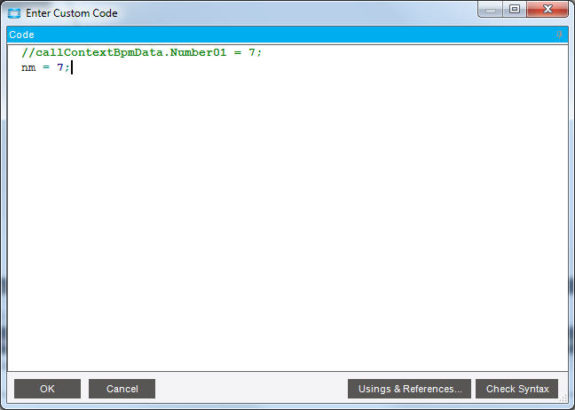

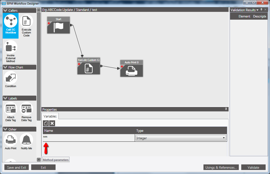

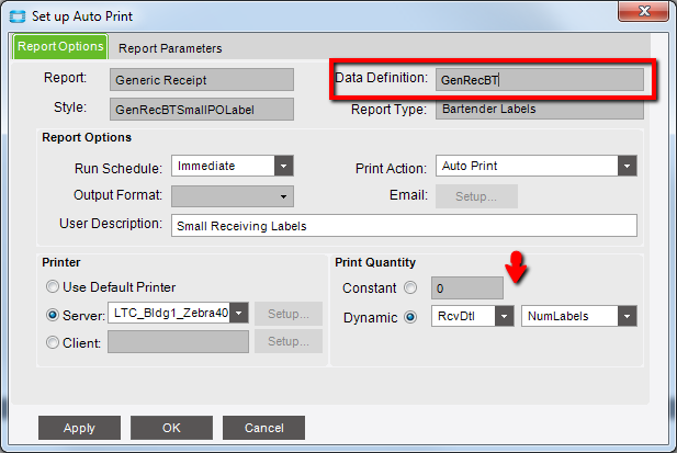

Did you ever figure out how to do this? I’m trying to set the number of copies to print based on a UD field in WorkStation. My first thought was to copy that value to a BPM variable, but AutoPrint apparently cannot use BPM variables. The best solution I’ve found is to use a field of CallContextBPMData.
@krum you should be able to use the following:
2018-05-09_1822
The list is populated based on what you have in your Report Data Definition, you would have to go to your RDD and add a few JOINs to get your Workstation.
Also if you look behind the scenes perhaps you can replicate some of Epicor’s Auto-Printing in Custom Code Block.
Or you could always do what @josecgomez would do :stuck_out_tongue:
2018-05-09_1910
2018-05-09_2004
Actually that might yield 987 copies because the second one would be empty… also I think Tuple is readonly like that - But you get the idea. (PS: Don’t do that! But think outside of the box :slight_smile: )
