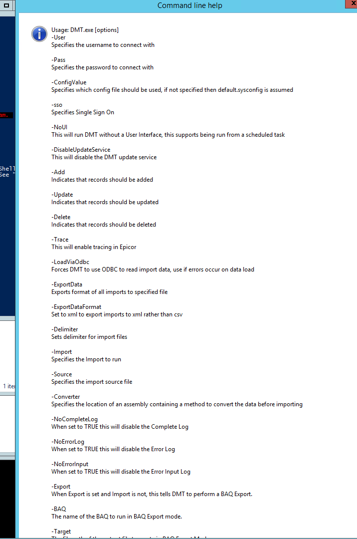

Does anyone have a full list of cmd line parameters for DMT 4.0.38?
Hello!
When I run dmt.exe /? I cant see all of the options! The msgbox is too long for the screen.
I tried piping the output to a text file to no avail.
I also looked at the dmt cmd labs guide on epicweb but it just says to run this command.
Thanks!
Does
dmt.exe /?
Work?
Or maybe -?
That’s what I was running. But it outputs to that text box shown above thats cut off so I can’t see the rest of the commands
Once the popup window comes up, make sure the window is selected/has focus, then press Ctrl+A and then Ctrl+C
Then open Notepad and paste (Ctrl-V).
The text content of the window will be in the Notepad.
This is a handy Windows trick to capture error message text for reporting issues and such too!
-Rick
That worked! Awesome thank you!
