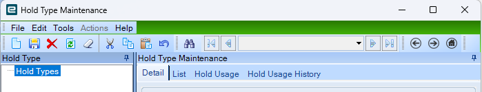

I can only get it to open the full Hold Type Maintenance and not the one that opens with the system provided links.

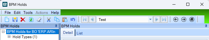

System one
When I manually add
Can you post more screenshots, see if I can replicate it and debug quick. Looks like now we just need to figure out why Epicor launches one form and not the other. Because it looks like it is a singular form and based on some logic inside, it decides which tabs to show and which title to use.
Also can you check the UI Binding and BO… Perhaps it uses a different BO and when it can’t find a Hold Type defined, it defaults to the Maintenance Program.
Let me know if this doesn’t help @hkeric.wci .

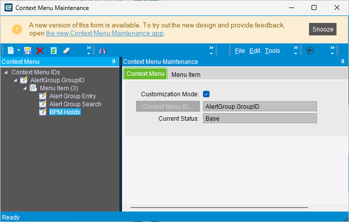

Customize Context Menu Maintenance add a EpiUltraGrid and set the EpiBinding to MenuItemView.
There are 2 more columns you have to fill out:
  1. Make sure the Item Name is BPM Holds (it must be exactly that)
  2. Set Process Type to BPMHoldAttach
  3. Set BPMHoldBOName and BPMHoldSystemCode
That should do the trick. Epicor probably never finished this, since they have Holds on most Objects.
