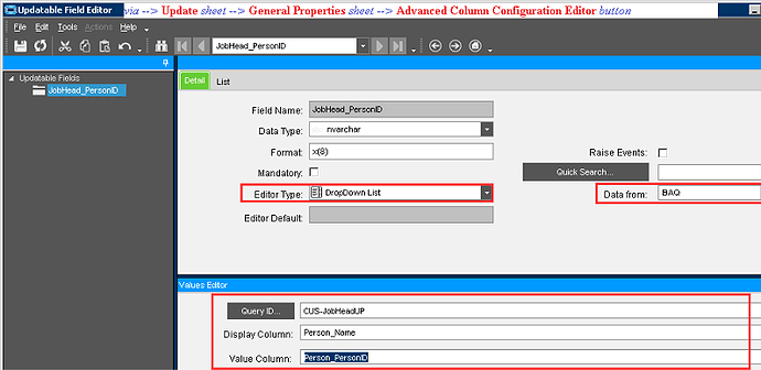

Yes, one option is to use User Codes and have the dropdown populate in the BAQ (Advanced Editor Options) this will make it so that the dropdown automatically gets populated from the BAQ Level.
Thanks Jose – I’ve looked through the BAQ screen, can’t see Advanced Editor options. Application help doesn’t show my anything either – can you steer me in the right direction please.
Right here
http://jcg.pictures/gdgdjhjaifKiaqq.png
Cool thanks – easy when you know how!! Is there an equivalent for a normal grid on a screen, where you’ve got a UD field displayed? Is it code requirement like Brian showed, or is there a built in way?

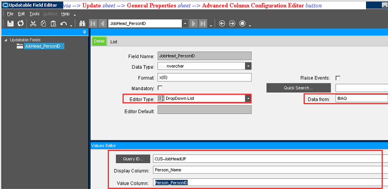

Looked like the old link isn’t working.
So… just adding a screen shot
