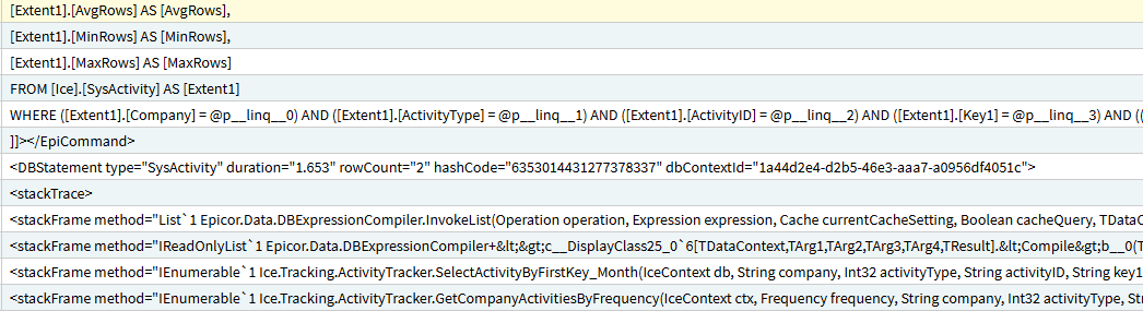

Well, here is something adjacent, the ability to set traceflags in outbound and receive back callertrace and detailed application server log output.
You can at least see some stack trace and sql info that way upon executing.

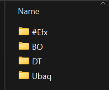

Are these the files that you are looking for?
lol @klincecum laughing.
I never bothered playing around with the dump sources thing so idk what files are expected from that but I dug around on the cloud server we have and found these.
