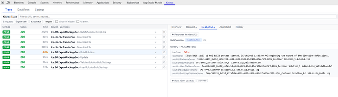

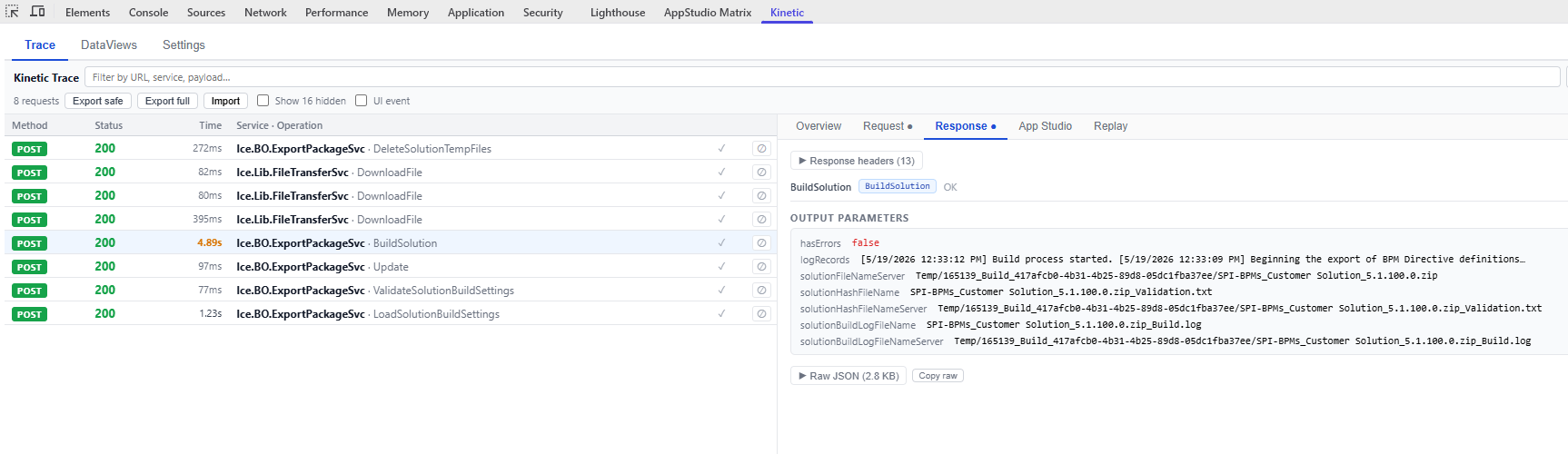

Looks like you could call
/Ice.BO.ExportPackageSvc/BuildSolution then
/Ice.Lib.FileTransferSvc/DownloadFile and
the files probably stay there until
/Ice.BO.ExportPackageSvc/DeleteSolutionTempFiles is called
FYI - it’s Folder = 4 on the Download.
That was a far as I got as well. I think i might have just psyched myself out thinking I needed to resolve that full path to grab it from there but I don’t think I tried just repeating the relative path. I’ll take another look. Thanks!
