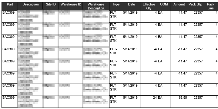

As an example:
This was corrected (at least in part tran) to only have 1 PLT-STK transaction.
But were are seeing in Inventory/WIP that only 2 of these were properly deleted.
How can we back out the remaining transactions?

My first guess would be that the TO receipt was done (rcv’g 24), then “undone” 6 times (-4 each), and then received as just 4.
Check the systime and tran num for each of the part trans. If the system is doubling them up you’ll usually see nearly identical systimes and sequential tran nums…

All those trans use the same PackSlip number, and if you take the sum of the tran Qty’s it nets out to receiving 4 (from +26 - 4 - 4 - 4 - 4 - 4 - 4 + 4 = 4).
Go back and ensure that the TO Shipment of Pack slip 22357 was for a qty of 24. If it was, then there is still $229.40 in the Intransit account (20 x $11.47), and QOH of that part is off by 20.
If the TO shipment was originally for just 4, then you didn’t need to do anything. The 6 individual trans of qty (-4) each, would have reversed the receipt of 24. And the final receipt for 4, would have made everything square.
