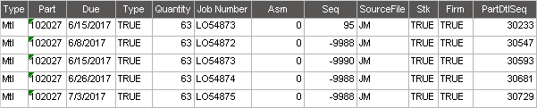

If you query PartDtl is there a record for that part? Have you looked at the SugPODtl record for any clues?
No
Yes, there are some job materials listed- are all issued complete.
The negative numbers in the Seq caught my eye though - wondering what is going on there?
Type Part Due Type Quantity Job Number Asm Seq SourceFile Stk Firm PartDtlSeq
Mtl 102027 6/15/2017 TRUE 63 LO54873 0 95 JM TRUE TRUE 30233
Mtl 102027 6/8/2017 TRUE 63 LO54872 0 -9988 JM TRUE TRUE 30547
Mtl 102027 6/15/2017 TRUE 63 LO54873 0 -9990 JM TRUE TRUE 30593
Mtl 102027 6/26/2017 TRUE 63 LO54874 0 -9988 JM TRUE TRUE 30681
Mtl 102027 7/3/2017 TRUE 63 LO54875 0 -9988 JM TRUE TRUE 30729
based on the log entries it seems like it is finding those negative sequences. I would try to uncheck and recheck issued complete to see if it would correct the partdtl records.
I thought that would be a good guess too… unfortunately no change to suggestions.
  • at least when changed from job entry - materials grid.
  • I might try reversing material issue next.
Thanks for the ideas.
Reversing materials issues doesn’t clear out the rows in PartDtl that have negative Seq values.
Now I’m thinking these are orphans/corruption.
