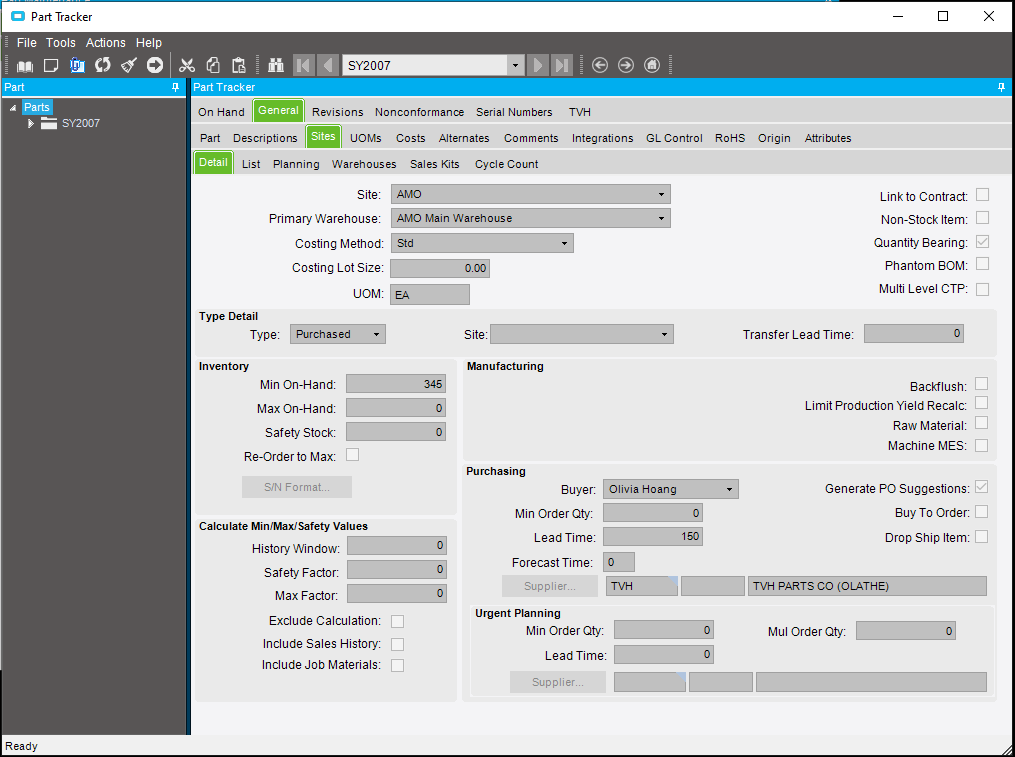

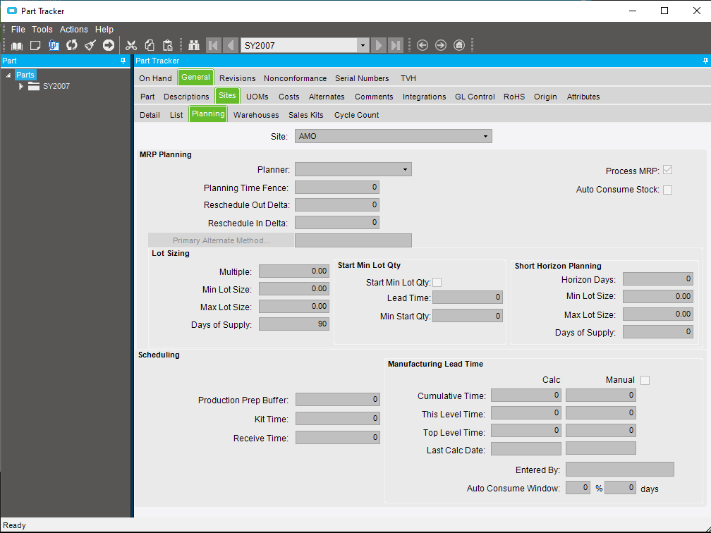

I have a few PO Suggestions on parts that the business has brought to my attention.
I have looked at the MRP log and it seems like the PO is getting suggested before it makes it through all of time phase. Maybe I am missing something here.

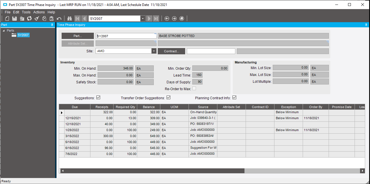

Here is a screenshot of Time Phase:
What am I missing here?
