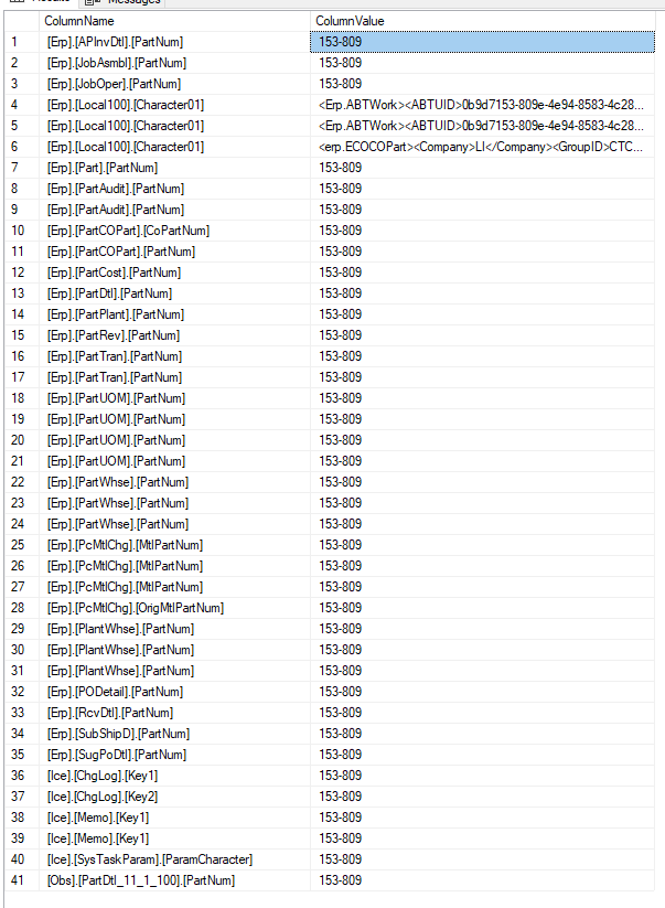

I searched our whole database for the part number in question, it has to be coming from here right?

Maybe it has something to do with CoParts… the items in PO Suggestions are listed in CoParts, while there are other items on the original job that aren’t in the CoPart table and aren’t on the suggestions… not sure what to do if this is the problem.
That last image looks like it is a co-part of itself. Both PartNum and CoPart fields are the same.
And it’s purchased AND a CoPart?
I’m guessing that you use it’s “parent” in an assembly, but only need part of it. So you put the unused portion into inventory via CoPart. That sound right?

THB I’m not familiar with CoParts. No co-parts are listed on the Job Closing Co-Part tab. So I’m not sure this is the issue.
Yes the part number and copart number are the same.
The part is manufactured, on the job as an assembly with operations.
Are you seeing that it is purchased somewhere? The suggestions are for Operations on the part, not the part itself…
I’m not seeing any inventory entry for a CoPart, just Part.

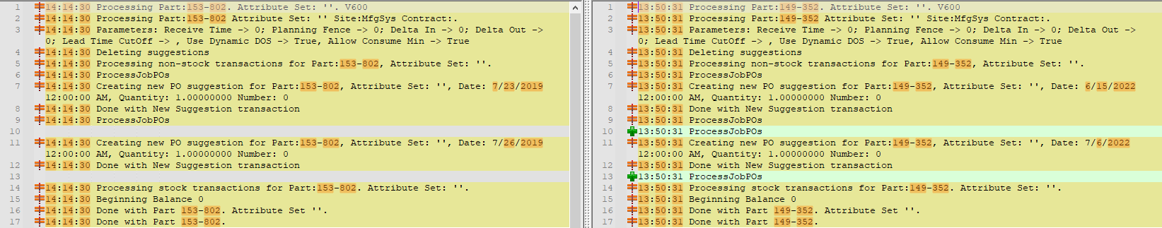

So it is in the log, but I don’t see how to diagnose… no differences.

As far as I know ProcessJobPOs are for buy direct items. We don’t use them, but when I checked my regen log I had over 150 direct suggestions, so thanks for helping me find them. Have you thought about running the refresh quantities process in test to see if it has the part and fixes it.
https://epiccare.epicor.com/epiccare?id=epiccare_kb_article&sys_id=6b40d7be1be4b348e596a79b2d4bcb1b&table=kb_knowledge
Yes actually I just ran the Refresh Quantities and Allocations report for that a couple hours ago, it found several items, but not these bad suggestions. I am going to run update at EOB today.
