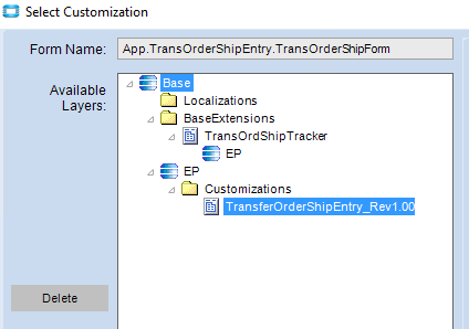

Hello,
I tried to customize Transfer Order Shipment screen and when trying to set as the default in Menu Maintenance I do not see the customization.
I did the “Refresh List” and create different customization and seem like did not show up. What am I missing? Any suggestions? Thank you in advance.
You have to check all companies in the customization.
Thanks Brandon! that works

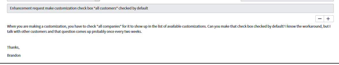

I just submitted an enhancement request to support to have that box checked by default (@aidacra). So hopefully they can make that question go away.

So this is what I put in for a case to service.
and this is what they responded.
