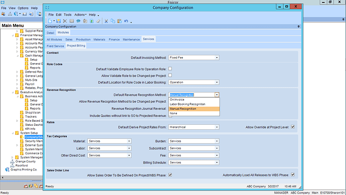

I am trying to set up E10. In Company Configuration, Production, Job I am trying to set the default Standard Format from pcs/hr to hrs/pc but keep getting a business logic error “Default Revenue Recognition Method cannot be None or Blank when not allowed to be changed per project.” I have no idea what this means! Any ideas?
Thanks,
Melissa
Its looking for this field under the services tab in company maintenance

Thank you! They should put that first if you have to fill it in before the other options
Ain’t that the truth!
