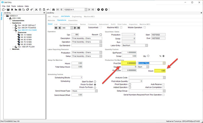

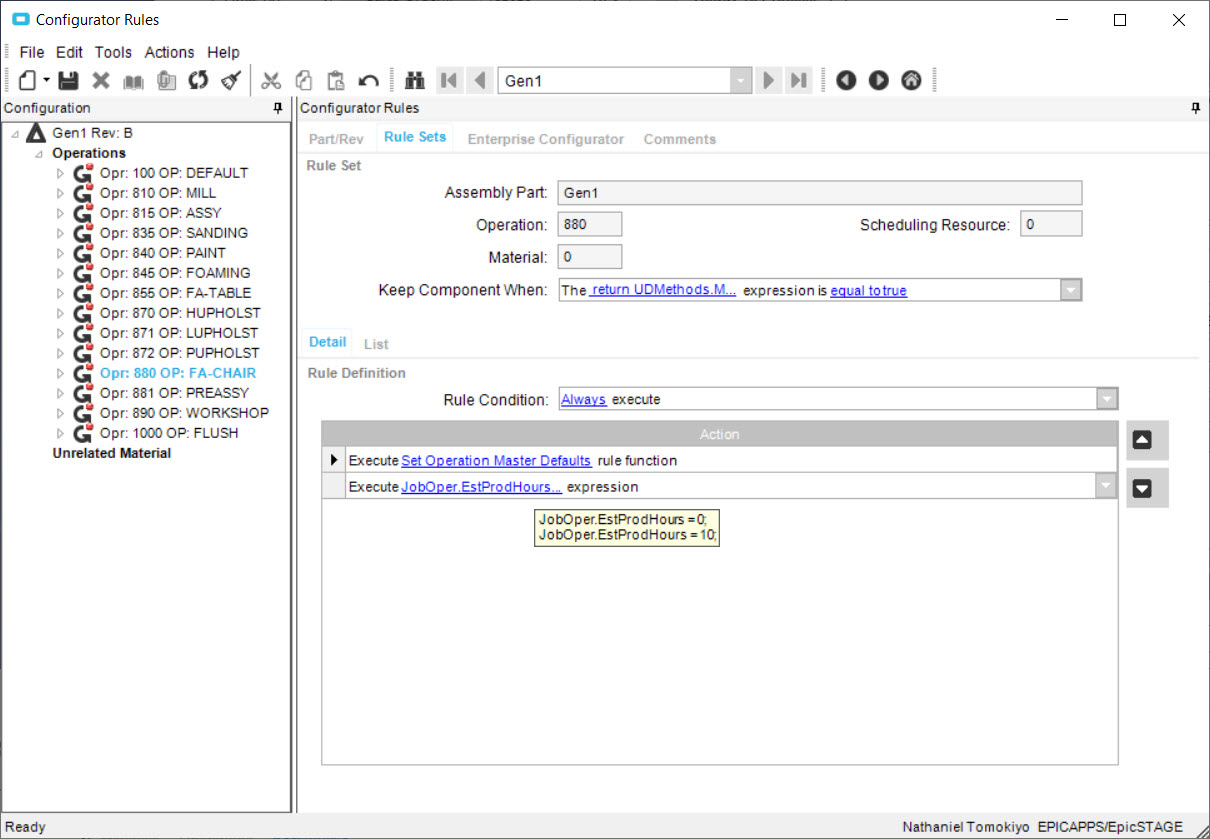

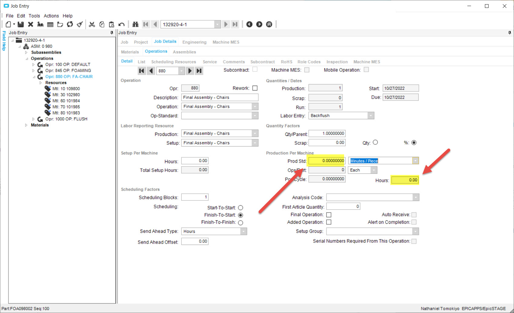

I am trying to set the field for JobOper.EstProdHours in the configurator rules but cannot seem to get it to actually populate when the job is created. I have tried this without Executing “Set Operation Master Defaults” as well as not including the “JobOper.EstProdHours = 0”. Does anyone know what I am missing?

I actually just realized that I need to populate JobOper.ProdStandard not EstProdHours. EstProdHours gets automatically calculated once ProdStandard is inputted
