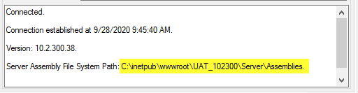

Our Production App is up and appears to be running fine, but there’s something in EAC that doesn’t look right. After connecting to an App, the Server Assembly File System Path value normally shows a path like:
That’s from our UAT (User Acceptance Testing App).

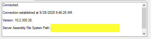

But the Production App shows:
It’s not actually blank, but rather a single dot(.). And if my DOS memory is correct, a single dot is the reference to “the current directory”, while the double dot (..) is the parent directory.
Any who … Really seems like this should set like all the others:
DEM_102300: C:\inetpub\wwwroot\DEM_102300\Server\Assemblies
UAT_102300: C:\inetpub\wwwroot\UAT_102300\Server\Assemblies
TST_102300: C:\inetpub\wwwroot\TST_102300\Server\Assemblies
PRD_102300_WUC: C:\inetpub\wwwroot\PRD_102300_WUC\Server\Assemblies
not
PRD_102300_WUC: .
Should I be concerned?

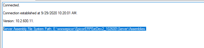

Not seeing that on our 102400 or 102600 environments. Have you tried redeploying the app? I know it’s your PROD environment so you’d have to do it off hours.
