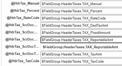

I would do a recording of the process to see what data was being sent in and out of ERP and compare that to a taxable invoice created in Epicor in SSMS to see what values are different.
Any missing pieces can be filled in in the ECM workflow or a bpm.

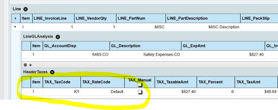

Thanks @gpayne for the Tax info. So it sounds like some company setting for Vendors isn’t coming or setup correctly from E-10 (yes it does populate the LineGL Analysis after manually entering the tax info)…

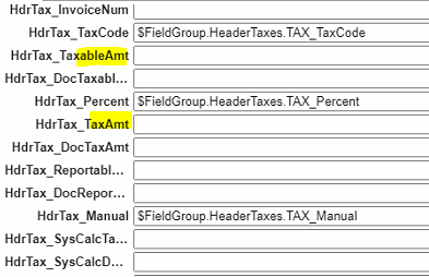

I did notice, but you would need to check a recording to see if my assumption is correct that I don’t think Taxable and Tax amounts are being sent back to the workflow.
