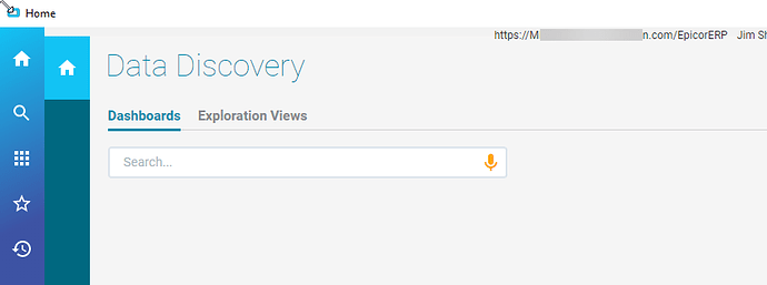

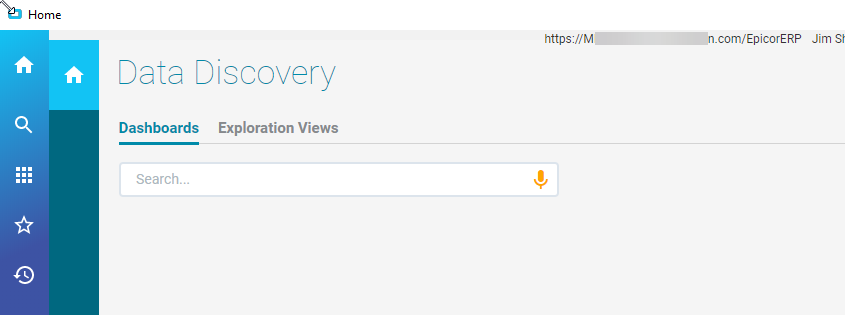

Trying to get started with Epicor Data Discovery and getting this blank page. Seems like there should be a big ‘+’ icon to start a new dashboard. Also when I edit an existing dashboard I can’t save it. I have full permissions in Epicor (except security admin). Are there some other permissions or group somewhere I’m missing?

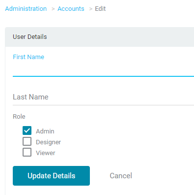

You’ll have to get into the user setup as an admin and set yourself up as more than a “Viewer” in order to create:
Ok yeah I don’t even get that. I’m asking our system admin now…
Yeah, I would set yourself up as “Designer”. That should allow you to create content.
