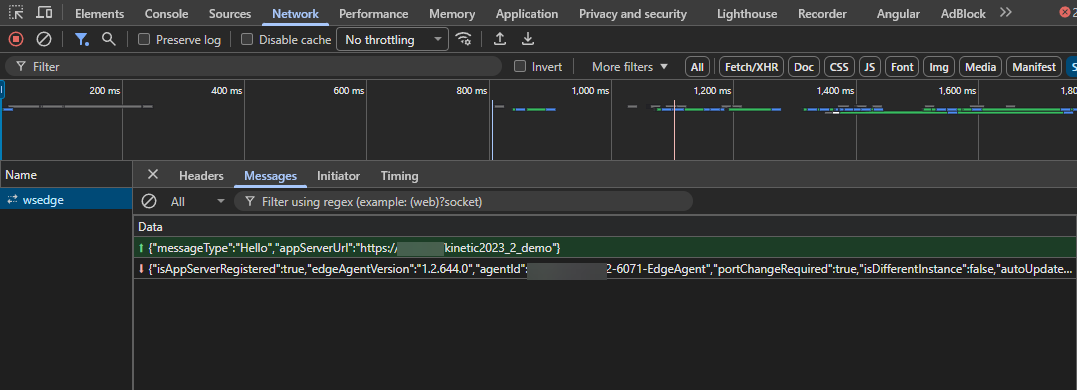

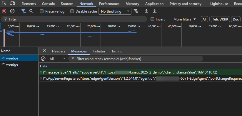

The actual web socket payload there are some differences between 2023.2 and 2025.2, I think that’s what you are referring to @Olga
Here are some screenshots after a refresh of the browser for each version
2023.2

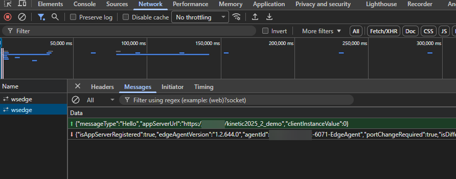

2025.2
As we can see 2025.2 generates two wsedge socket requests and 2023.2 only 1. With some differences (clientInstanceValue. The null references I have seen while testing have been because of that payload difference.
From what it looks that value tells epicor which edge agent port to respond on, whti that information being stored in the browser.
The way this is generated is baked into the the js, so really nothing that can be done. Sadly 2023.2 is in sustaining support so there is little that is going to be able to be done about this.

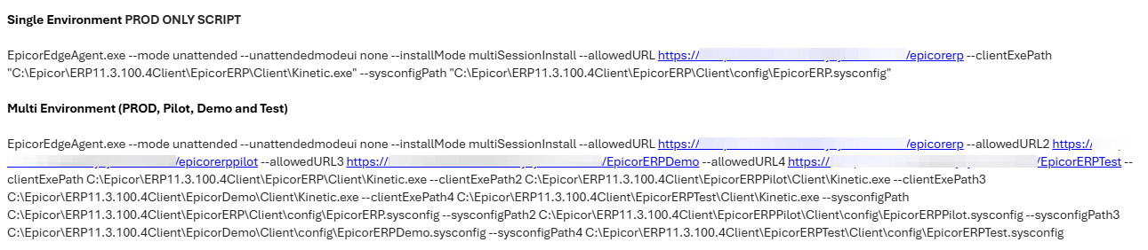

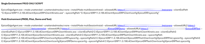

After testing I can confirm that the URL Olga provided is the network installer for 1.2.644 and if you install manually, you see the following options. We chose “Local installation for virtual desktops”.
Only thing we had to change in our script for the network installer 1.2.644 was to add the –sysconfigPath for each environment. –InstallMode multiSessionInstall still works.

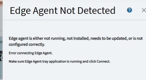

@leonardpothier Can you confirm that your users still have to use their default browser?
Network installer for 1.2.644 gives us all the other functionality we need (Switch users, Open Classic apps, printing etc) but if they don’t use the default browser we get the below error. I was unclear from Olga’s comments whether that was still the case with newer Kinetic versions than ours.
