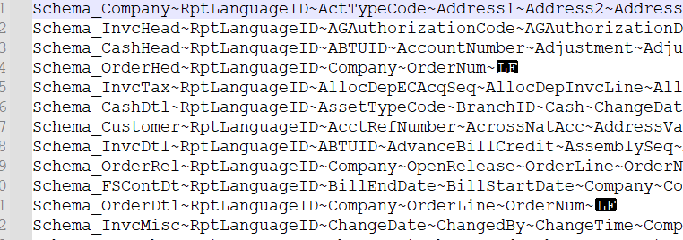

we went kinetic web last weekend and we are having EDI format issue since then..
seems that the END of line went from CRLF to just LF.. those are now beging reject by our customer.. I have open a ticket with Epicor but nothing so far.. any suggesting
ex of last weekend move to Kinetic WEB

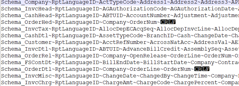

before upgrade

Possibly related to the linux migration since linux uses LF instead of CRLF.
Not sure how youd fix that other than the customer updating things on their end.

Hi John,
File can read no worries. But as the delimiter changed, the mapping can’t read the others lines.
We tested with CRLF and not LF. We need to receive it with CRLF as EOL delimiters.
We should received as it is before.
