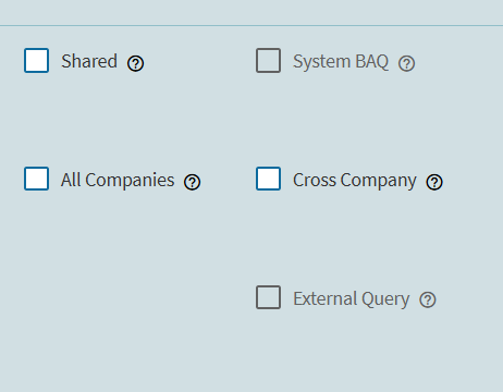

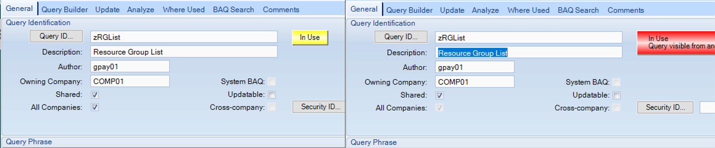

I am having a security issue with multi company baqs and sql. In the non owning company I am getting an error connecting to sql. I have scoured this site and EpicCare without finding an answer.
The baq works in my company and works for me in the new company, but fails for users that only have access to that company. I know it is company related because if I give a user from the non owning company my company the baqs work.
Any ideas on what setup I missed?
