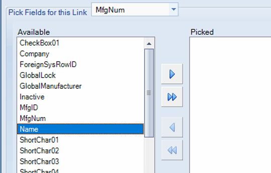

I’m not at a computer so I can’t say for sure. But I bet on the PO Detail data source you can go to linked tables and select the manufacturer ID, Then on the picked columns you should be able to see the manufacturer columns including Name. You can select it. Then it will be available in your report to add. See if that helps. If not, I’m glad to look into it when I get back to my machine.
Hi Dan,
I did what you asked, but there was only MfgNum available. I have created a BAQ that translates MfgNum to Manufacturer Name, but also unsure how to pull that into here, if that is possible.

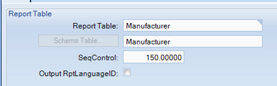

The RDD needs to have the Manufacturer table added then a relationship from PartXRefVend or PartXRefMfg to the manufacturer. I did a mockup.
Assuming you already have duplicated the POFORM you also need a duplicate RDD.
make a copy of the RDD with duplicate report, unless you already have.
Add table, pick from scheme
add an Output relationship
I don’t do RDDs a lot, but I had to clear and reload the POFORM to see the fields. Uncheck the Name and label.

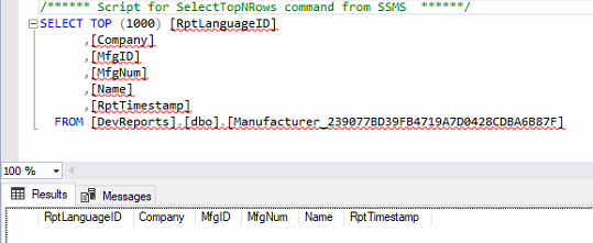

I looked at the temporary tables being made and there was no data.
To check the temp tables run the report or do generate only with an archive period
Then open system monitor report tab and find the filename column
copy the file name and then open ssms and expand the ssrs report database then filter tables with the table guid id
This will show the list of tables generated for the report and you can query them for the data generated.
In my case the manufacture table is empty.

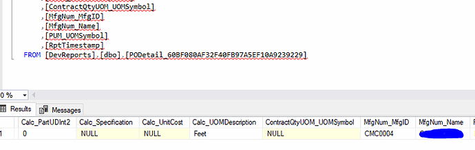

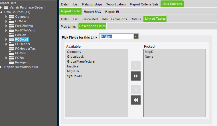

I went to the field help and there is a PODetail.MfgNum that @dr_dan bet would be there.
I went back to the rdd and in PODetail went to linked tables and moved MfgNum to the right.
then in description fields picked name
I did the upload / download process again and then generated.
now in the PODetail at the bottom is MfgNum_Name and in the data is the name.
