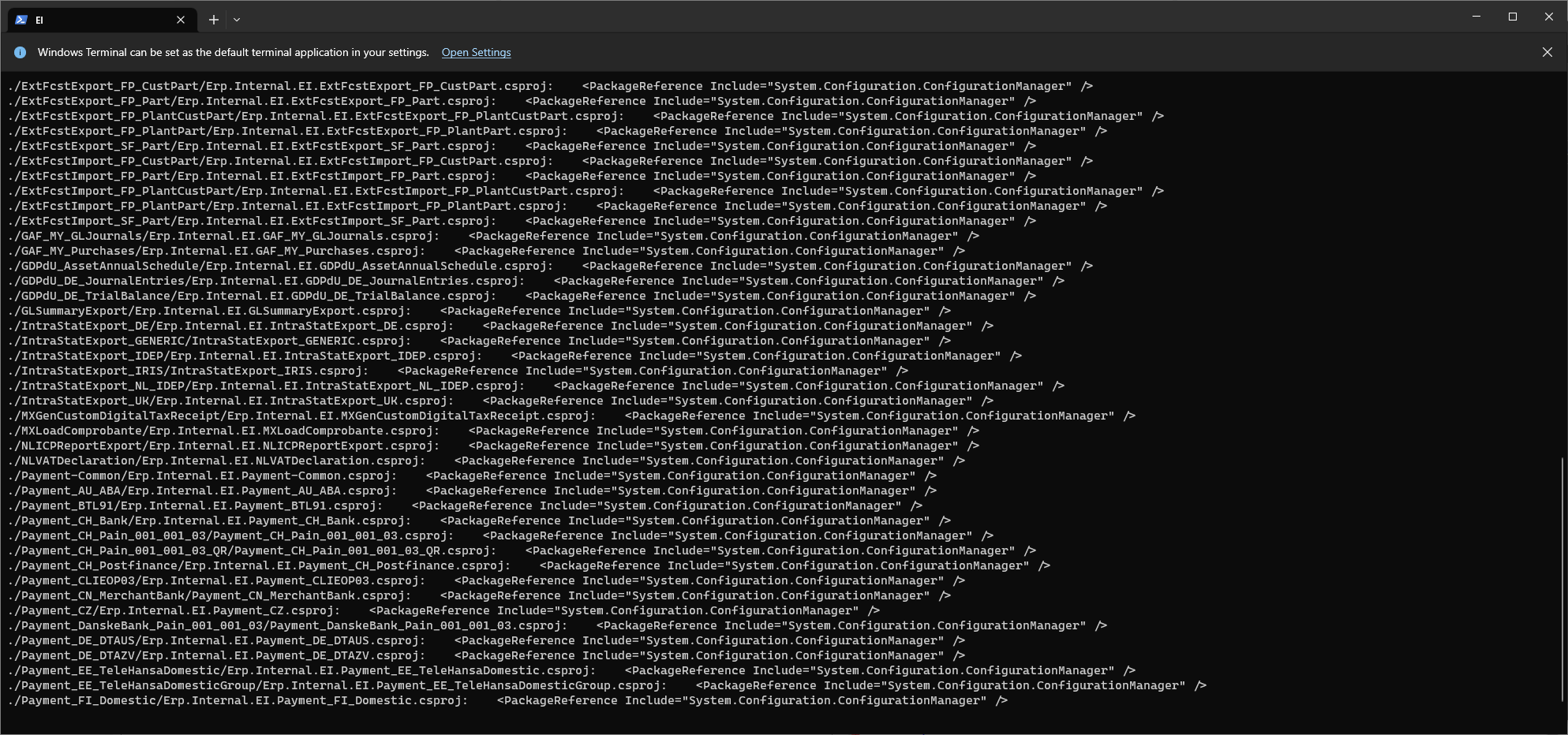

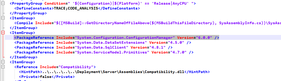

Any idea on how to fix this? I found the file and see the reference is:
string asmPath = (System.Configuration.ConfigurationManager.AppSettings[“AssemblyFileSystem”] ?? “”)
.Split(new { ‘;’ }, StringSplitOptions.RemoveEmptyEntries);
Thanks!
I searched the site for ConfigurationManager and found this thread.
