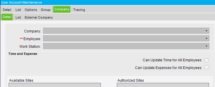

Gotcha ok if he is using the full-client he may need his Employee ID Associated to his UserID… under User Account Security Maintenance you can link the Employee ID to his User ID.
They may need to logout/login
Thanks! That’s what I was missing.
That solved the error for me. Thank you!
