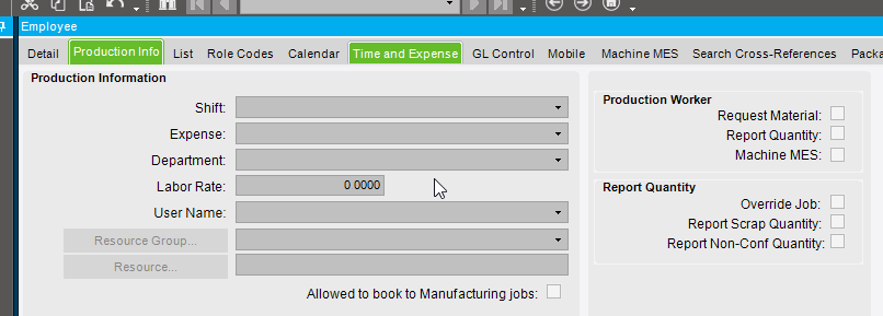

Do you need to setup the employee with a Work Force record too?

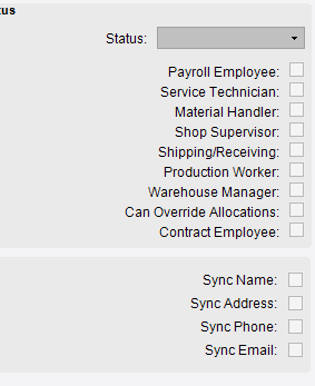

Id also check that perhaps you may need Material Handler? / Warehouse manager? on employee record:
Or perhaps the username referenced here :slight_smile:
