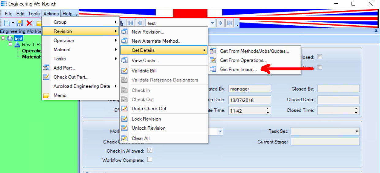

We want to try and get the below working were we import BOM’s from solidworks. The below video link shows the user opening engineering workbench and clicking the group search…he then finds his BOM…(note the BOM was in excel and he placed it in a folder named “filedrop”.
How does this folder link to the group search in epicor??..that’s the problem i have.

Is this the way forward? if so, what are the required fields for a template?
Company, plant, partnum??

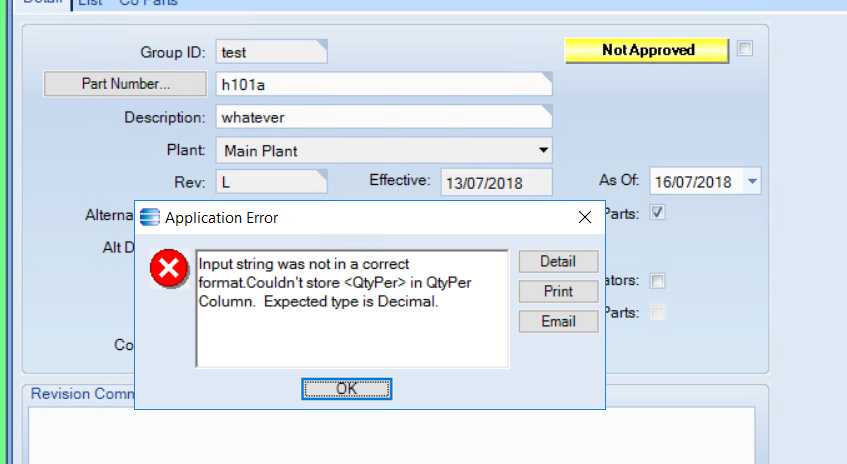

latest update i seem to be having a few problems with the formatting of the QtyPer field…i get this error:
If i open the file in notepad, you can see it has 2 decimal places
Hi Mark,
Try removing the header row.
Mark W.
