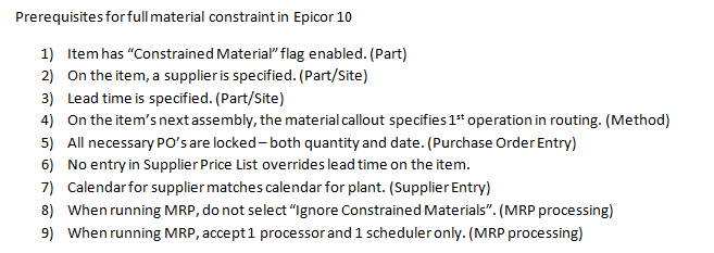

Here are the instructions that I’ve written to constrain material in the “current version” of the software. If executed, this will work, as long as the version of the software you are using functions properly. This may be overkill, but we spent an enormous amount of time validating that constraint did not work in V8, and does work in the “current version”.
Thank you Gil for sending out this detail. #9 was a surprise to see on your list. I’ve never learned much about the processor and scheduler counts, but I guess I need to do so.
On the subassembly constraints, I was also told the “Multi-Job Scheduling” does a better job than previous versions of making sure the subcomponent job stays a constraint for the parent, but I’ve not looked into it enough yet.
Thanks again for the detail.
It was an enormous effort getting to this point, but I can say with certainty that if these steps are followed, a constrained item will not go below zero in
Time Phase.
Hi @Gil_V
We are seeing the same issue in Epicor in that constrained does not make a change to job date. I will run through the list of nine items you posted but just have a couple of questions. On Step 1 is it the part in the assembly that should be constrained or the top level part? Could you clarify step 4?
The callout for the item you want to constrain has to be set up properly on it’s next higher level assembly in the method. So if the assembly is a “picnic basket” and you want to constrain on the “handle”, put the “handle” callout on the first operation in the “picnic basket” method.
This might be overkill, but we tested this so extensively that we had to eliminate any chance of failure. We were primarily concerned with constraining raw material, which would be needed on the first operation of it’s parent.
