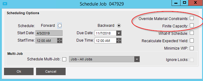

It sounds like you might be doing finite scheduling. With finite turned on, you are not allowed to over-fill a finite resource… OR if you have a constrained material, you will have the same problem.
When you reschedule a job, there are check boxes to override these. Turn ON the override material constraints, and turn off the Finite Capacity.

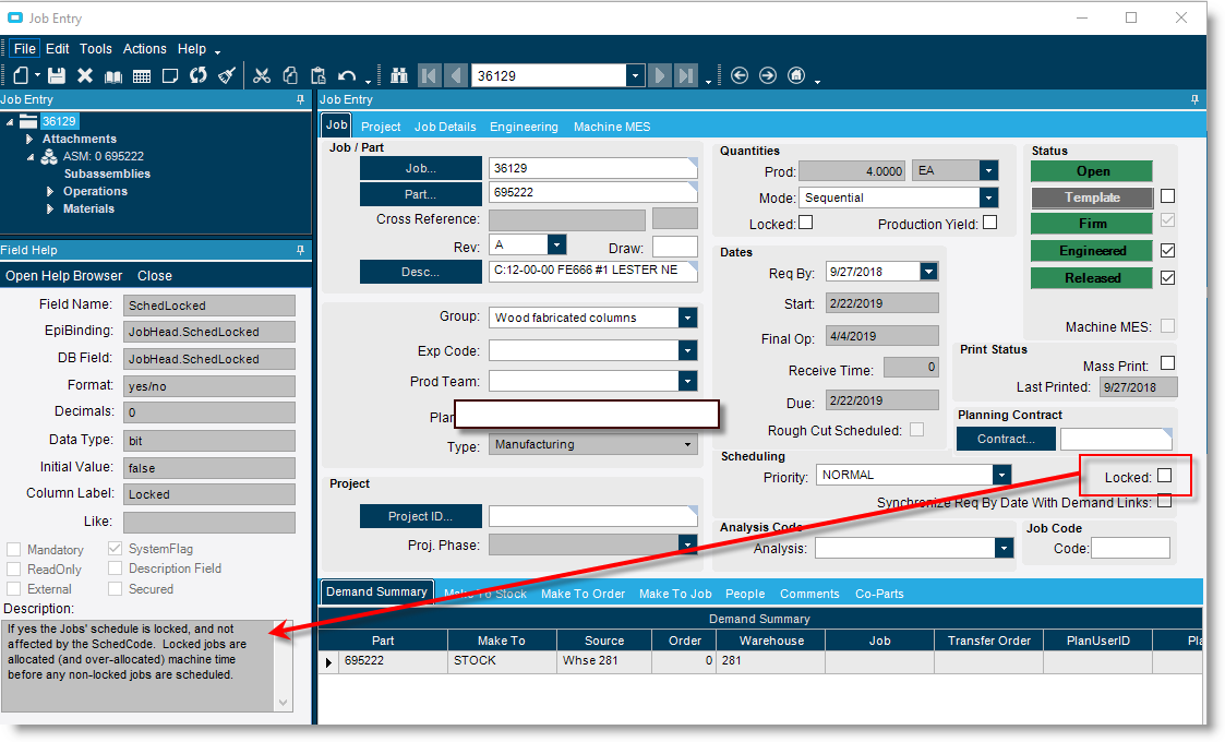

You could try Locking the Job Schedule, this should keep the important customer Jobs in place and suggested Jobs would be scheduled around it.
Set your required dates and check the ‘Locked’ check box on Job Entry.

Yep, I get how finite scheduling is supposed to work, however we are seeing jobs push out and there isn’t anything else scheduled in the resource. I tell the system I need the job by 4/8 and schedule it and it will start it 4/15 and won’t let me pull it in any sooner. We have tried to forward schedule a particular job and it just won’t budge.
do you have a constrained material?
FYI. Buy direct materials on a job are considered constrained materials. Those materials lead times will dictate the related ops start date.
