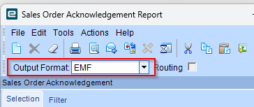

I’ve found that if you are printing to a PDF printer (such as Foxit PDF Printer), you need to select the EMF output format. This will then be converted to a “full” PDF by the PDF printer, instead of one large image.
Interesting, I just tested this and it does appear to solve my issue…
