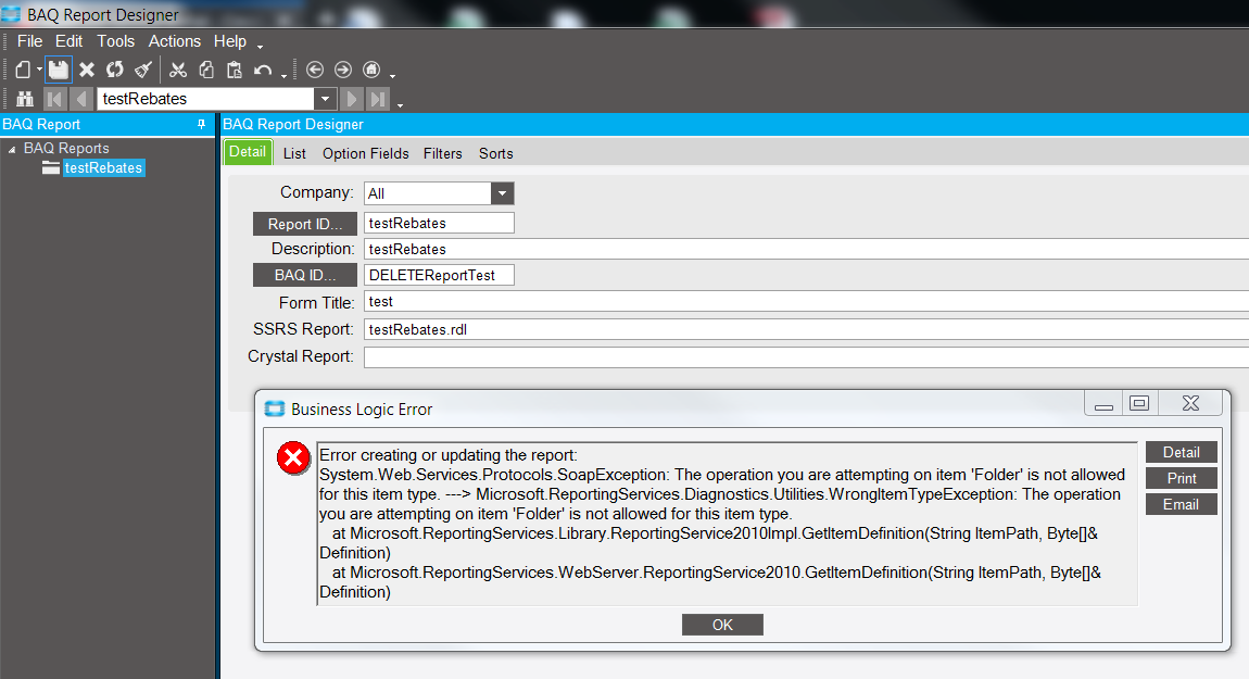

When trying to create a report from an existing BAQ, that consists of only 1 table and a few columns, I receive the error at the bottom of the post, here’s the main error:
(Error creating or updating the report:
System.Web.Services.Protocols.SoapException: The operation you are attempting on item ‘Folder’ is not allowed for this item type. —> Microsoft.ReportingServices.Diagnostics.Utilities.WrongItemTypeException: The operation you are attempting on item ‘Folder’ is not allowed for this item type.)
I’m just looking for where in the server settings and client settings I can look to ensure that the proper link is entered. This error looks like somewhere on the server is not pointed correctly. Where would the server link to the SSRS BAQ reports or Custom Report folder for the purposes of creating BAQ reports?
This error appeared after upgrading from 10.1.500.10 to 10.1.500.32. Creating BAQ reports wasn’t working at all in the previous version if the baq had sub-queries. I’ve been told by Epicor, and read in the patch notes that our current update resolves that. So I’m thinking that our consutlant who upgraded our software simply missed updating a link somewhere? Does this sound correct? If so, where can I look to determine if it is set up properly?
Business Layer Exception
System.Web.Services.Protocols.SoapException: The operation you are attempting on item ‘Folder’ is not allowed for this item type. —> Microsoft.ReportingServices.Diagnostics.Utilities.WrongItemTypeException: The operation you are attempting on item ‘Folder’ is not allowed for this item type. at Microsoft.ReportingServices.Library.ReportingService2010Impl.GetItemDefinition(String ItemPath, Byte[]& Definition) at Microsoft.ReportingServices.WebServer.ReportingService2010.GetItemDefinition(String ItemPath, Byte[]& Definition)
Error Detail
Description: Error creating or updating the report:

For anyone with the same issue, it turns out that instead of a template report called BAQReport.rdl, our system had created a folder named BAQReport in the reports/CustomReports folder. Delete the folder and then either copy an old BAQReport.rdl file from another location you have, or just create a custom BAQ report and Epicor should create a new template file.
