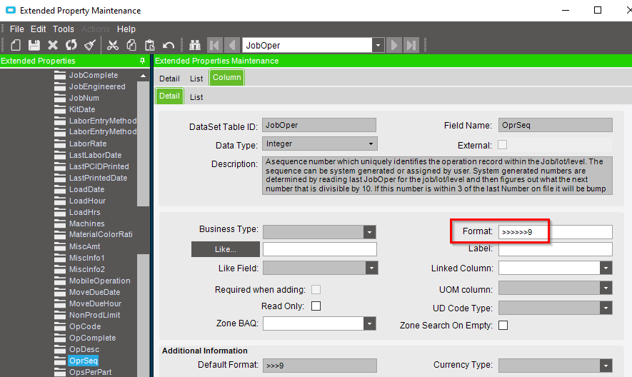

I was able to do this in my version. You need to go in Extended Properties for JobOper table and change the Format there:

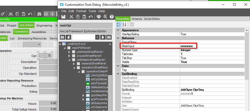

Then, in you job entry customization, change the Mask Input for OprSeq:

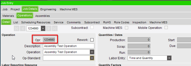

It will let you save with the new format:

Anyway, it doesn’t work. I get the same error Opr is too large for its format of ā€˜>>>9’ in both MES and Time & Expense Entry (I only changed the JobOper table).
