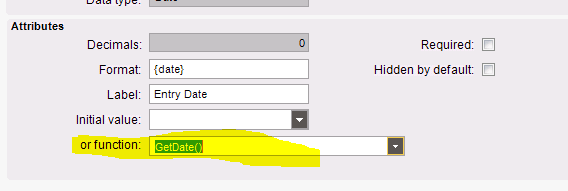

For example, would the following UD field be set when the record is first created?
And does the Required checkbox have to be set? I left it unset as this field doesn’t appear on the form and I didn’t want the processing to halt, if that somehow got FUBAR’d.

Did you add the default value by chance after your originally created it? I’ve seen it not go back and update the table if you don’t do it on the very first try
I thought that might have been it. But the last two entries were definitely after the pushing the update.
I’ll try it with the UD field set to “Required”
No not the entries on the table, I am talking about the actual table definition. At least on 10.0 if you go after the fact and change that it doesn’t go back to the table and recreate it always…

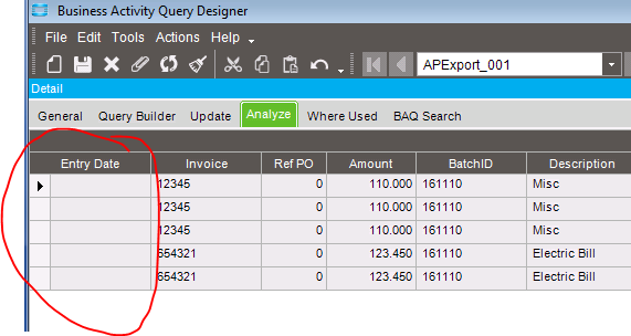

Here’s the sequence
Last week I added the UD field, did the schema update (or whatever it is called), and did the IISRESET. I assume that all worked because the field “EntryDate_c” (for the APInvHead table) shows up in the BAQ.
This morning, I added a new invoice to an AP Invoice entry group (was an existing group), and expected the field to be auto populated.
The field is not on the AP Invoice form. Is that a problem? I figured the Record creation is when it is set, and not that the field UI element is auto-populated, and then that UI objects value used for the record creation.

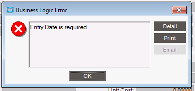

Hmmm … setting the UD to required gives me an error when the record is trying to be created.
So I guess it does just initialize the UI object with the initial value, and then use that for the record creation.
