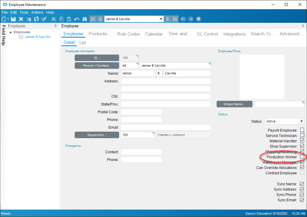

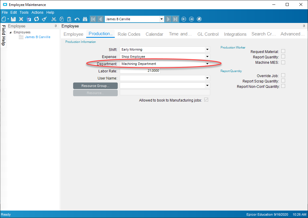

You could use department or the production worker flag.
Using department you may have to include/exclude a few departments on your report.
If you use production worker then the people who are not production workers can’t log into jobs. (This may be good or bad depending on your business)
