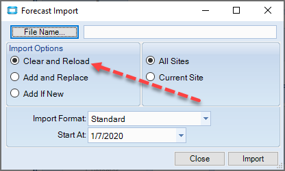

I don’t know if this information will be helpful, but here goes. The behavior you are seeing reminds me of when we have wrong Import parameters in Forecast Entry. We import a couple times a week based on data from a run dashboard. Not automated… but not awful. I have seen duplicate forecast records when the import spec wasn’t done correctly, particularly when a user did not click “clear and reload”. Could there be a parameter that is not doing the clear and reload?

Thanks for the reply. We are not using the import function at all just yet (we may end up doing that, except I can’t import the UD fields I need). I think in your case without the clear and reload you could easily end up with duplicate forecast records. That is not the case here as I have confirmed that there is only one record per part per date.
