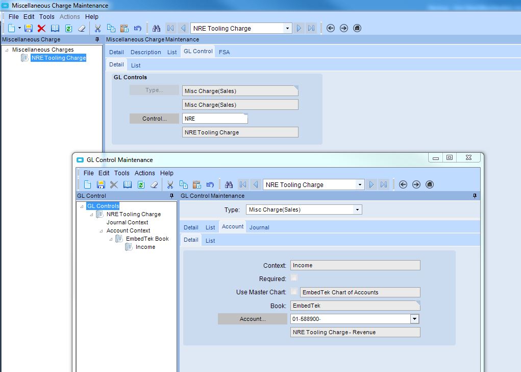

Open the Misc Code in its maintenance form. There shoukd be a GL Controls tab.

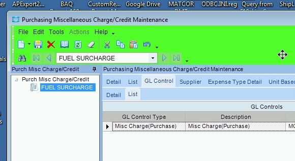

One misc charge that is coming over as Price Variance Account.
Is this the form?

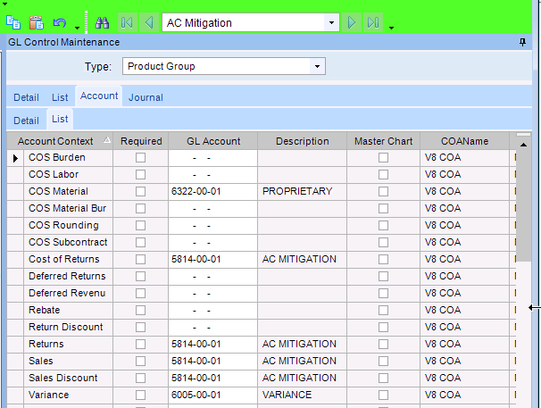

Select the list tab to show all the contexts
Each will have its own GL account assigned.
which list tab? GL Control or Misc. Charge Maintenance
Account -> List
Here’s a sample for prod group
It’s possible the GL Control has only a single Acct Context.
There is only one account in both of the lists.
My eyes are a little weary but it looks like you have the Sales Misc Charge selected and not the Purchasing Misc charge?
You might be onto something. How do I select the correct one? I tried but I couldn’t.

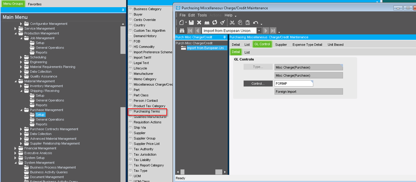

Are you opening the Purchasing Terms? From there - just right-click the control and open with GL Control Code Entry - This will get you to the correct place

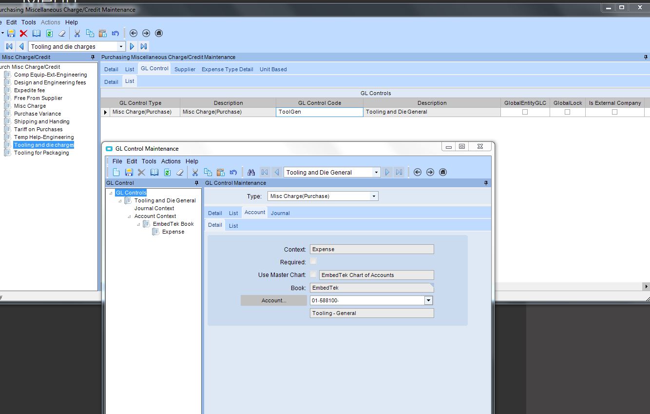

@knash - Open Misc Charges from
Materials -> Purchasing -> Setup -> Misc Charges
The window should be titled like:

ok I am there. Remember that things work on the PO header level not the line level. Is that even another set of rules?
everything is going to price variance though. hmm
